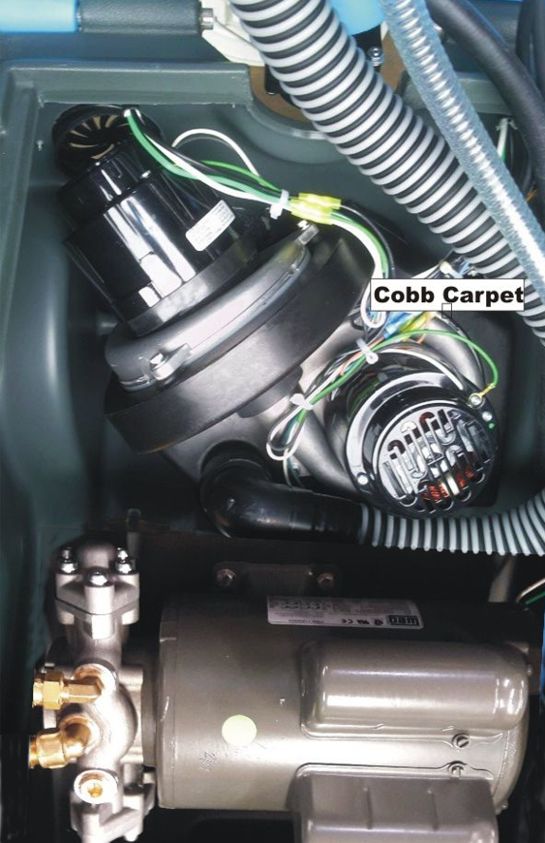

I've got a brand new machine design, to throw into the challenge.
Dual 6.6" vacs in series, for 215" lift for the long hose runs.
A Cat 2 GPM Pump system with efficient 3/4 HP AC Motor
for Tile & Grout cleaning.
Twelve Gallon Recovery and Fresh Water Tanks.
Two cords, primary 19 amps & secondary 13 amps (Pump Out opt.capable).

Yeah .. little better than the Clean Storm since the pump is 700psi .. but your 6.6 in series says 215'' of lift and only 140 cfms .. Clean storms 6.6s in series says 215'' of lift with 170 cfms .. is there a misprint? I like the 215'' of lift but 140 seems low.
I would say 140 CFM.
Here is the Ametek spec sheet on the vac motor:
http://dev.ametekfsm.com/Bulletins/122234-18.pdf

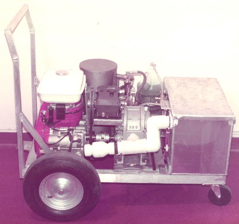

This is a scanned photo of the portable TM we built a few years ago. Aluminum frame with Pump-Out.
Since most of the weight was on the 13" Pneumatic tires, the front casters could be put on the van floor by one stout tech.

Bobby Walker
Apr 9, 2017
35
Midlothian TX
Bobby Walker
looks like a "hot rodded" tractor :)
pretty awesome build. i'm sure you could sell a few more
of those if you had them sitting in your store
so with this i guess you hook up to water and then it has
a pump out system on it?
I like that. Strip off the pump system and it would make a great WDR extractor for corporate jobs where you can't a truck close to the building.

Why not the smaller AC Ametek motor ? As is there is very little room for those motors to breathe.
Larry Cobb
5,795
Dallas, Texas USA
Larry Cobb
Horsepower is the reason. DC motor is only 1/3 HP.
AC motors are more reliable and in this case, very efficient.
That 1/2 HP AC motor only draws 5 amps delivering 1.5 GPM @ 500 PSI spraying.
Feels like a TM when you squeeze the trigger.
For T & G cleaning also, we go with the 3/4 HP AC motor delivering 2 GPM @ 700 PSI at only 7 amps.
Due to the high efficiency design, it only draws 19 amps at full output (7 + 12).
Strongest 2 cord extractor made IMO.
