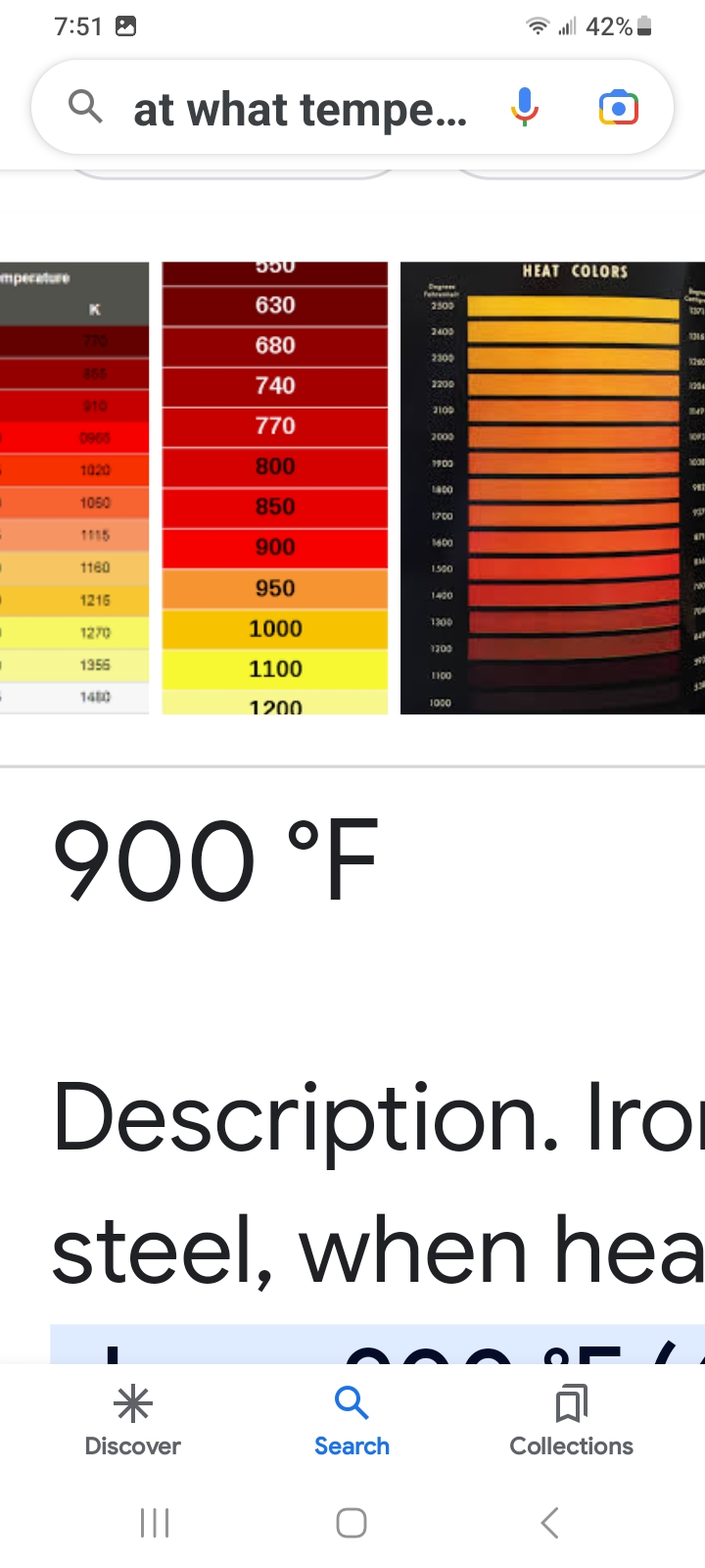

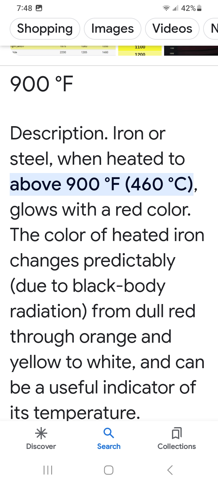

Aren't they supposed to glow?ive driven my vans more than once with the dog house off and noticed that the exhaust manifolds glowed, and while on a dino my Shelby headers glowed too. On the vans the manifolds would quickly heat up and glow under acceleration and quickly cool off when i let off the gas same on the mustang glow bright when doing a pull and cool right down as soon as you let up on the gas

I always read that glowing headers either was caused by lean fuel burn or bad catalytic converter. I had both problems and the glowing reduced almost 100%
I know some of these turbo engines in race cars are different, but a normal engine shouldn’t have a bright glow. My previous Titan and current Everest and now thermalwave don’t glow bright.
I only saw the mustangs headers when it was under load on a dino and the vans exhaust manifolds glowed when i accelerated hard, so under load also .
I don't know anything about these carpet cleaner engines i just assumed that under load they would glow also. I just googled normal operating temperatures for catalytic converter
