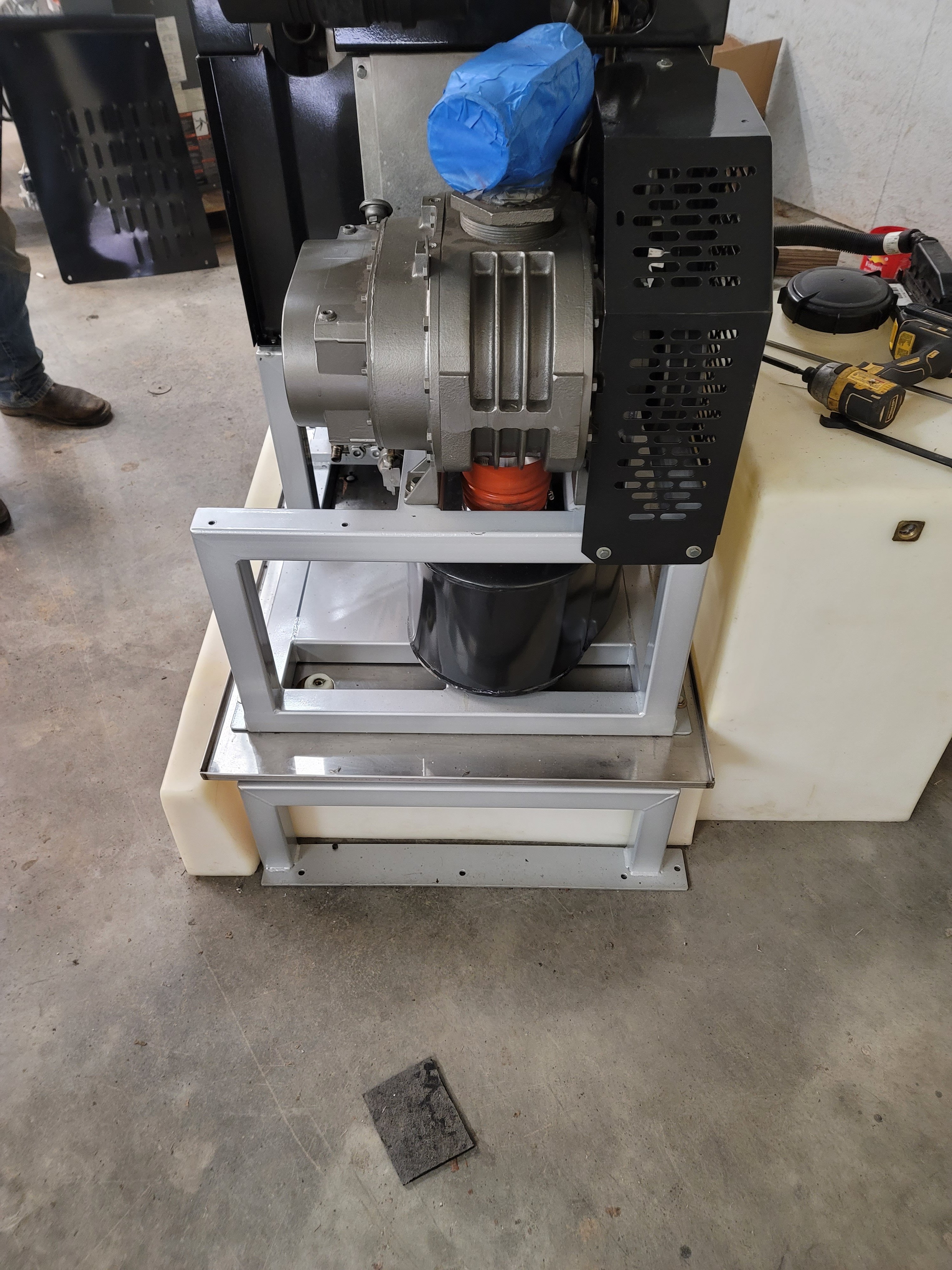

I’m taking it to the forklift later this week to move it. Rubber mats underneath are getting pulled up.
The waste tank was behind it but I think I’m gonna move it to the left side of the machine for better mounting space and ease of access to the rear and right side of the machine.

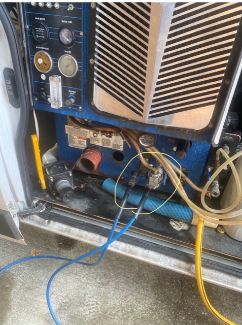

Here’s a better video of what it’s doing. My mechanic couldn’t tell if it was the engine or the blower

That noise goes away when I manually open the vac relief valve. Don’t insult me, I’m not a true dumbass

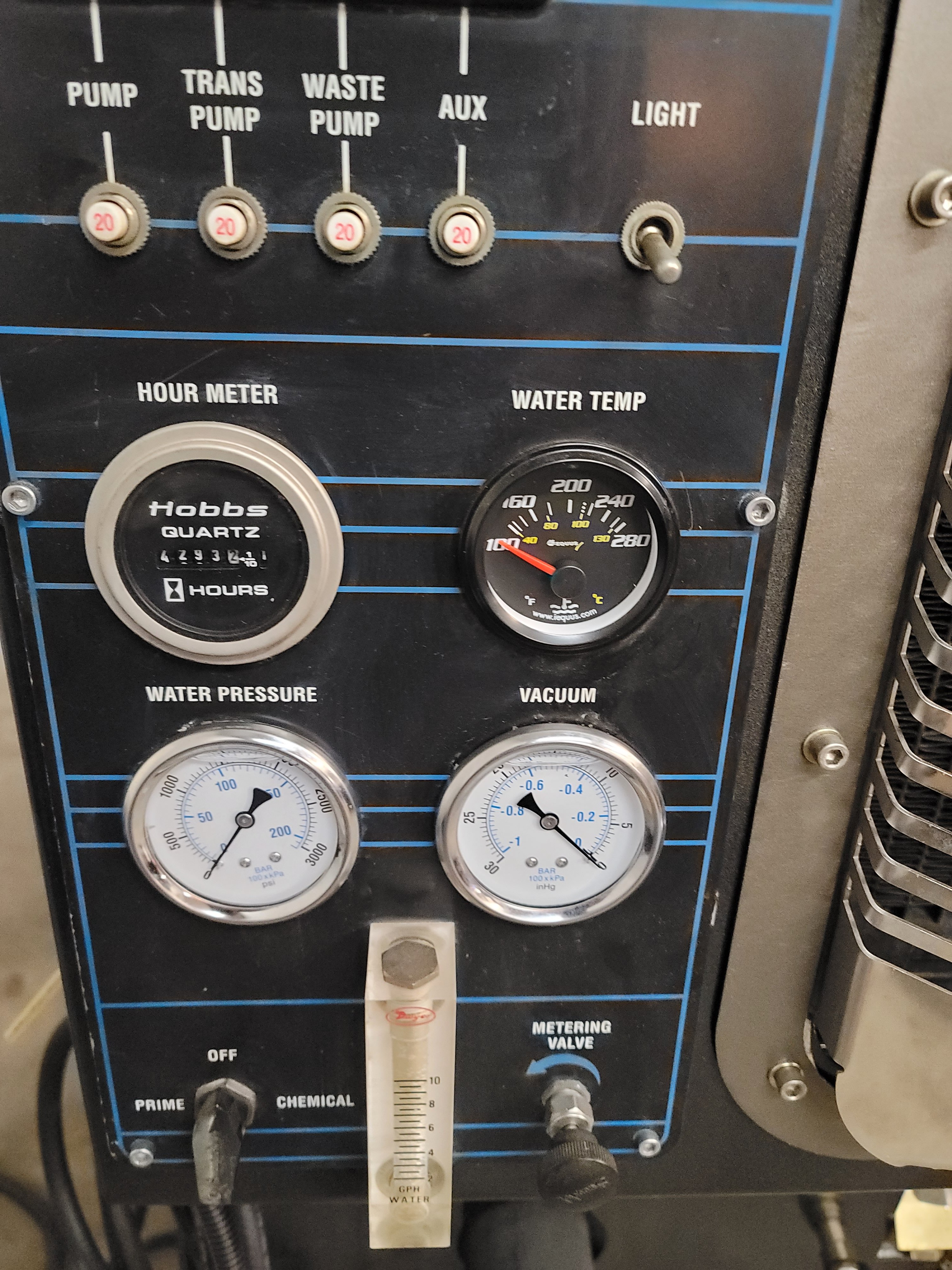

It shouldn’t be making that sound at 13-14hg

And when you see it making that grinding noise at 13hg
As I said the other day, sounds like a air leak.
Today's video, clearly a air leak but it sounds like it is leaking through your relief valve which is normal.
I know you say when you open the valve manually you do not get the noise but you are probably opening the valve further than it does during normal operation causing less restriction and less noise.
listening on my ph all I can hear is vac relief, listening on slightly better wireless speaker I still hear vac relief.. 🙉
welp, do this
crank relief valve tight so it won't open.
cover the hose end half to 3/4 or whatever is needed to load the blower to 14hg.
(make sure vac relief doesn't open at all)
you'll know then if hearing a bearing, belt squealing or air whistling thru the relief valve
so easy, even a Matt can doit
I worked on it this evening and found the problem. That sound is coming from an unevenly adjusted belt tensioner. I went to retighten the belt a couple weeks after the new one was put on and I forgot to loosen the pulley on the back end so it would move. It sounds like a new machine now
An uneven belt tensioner makes the engine sound like it's grinding.

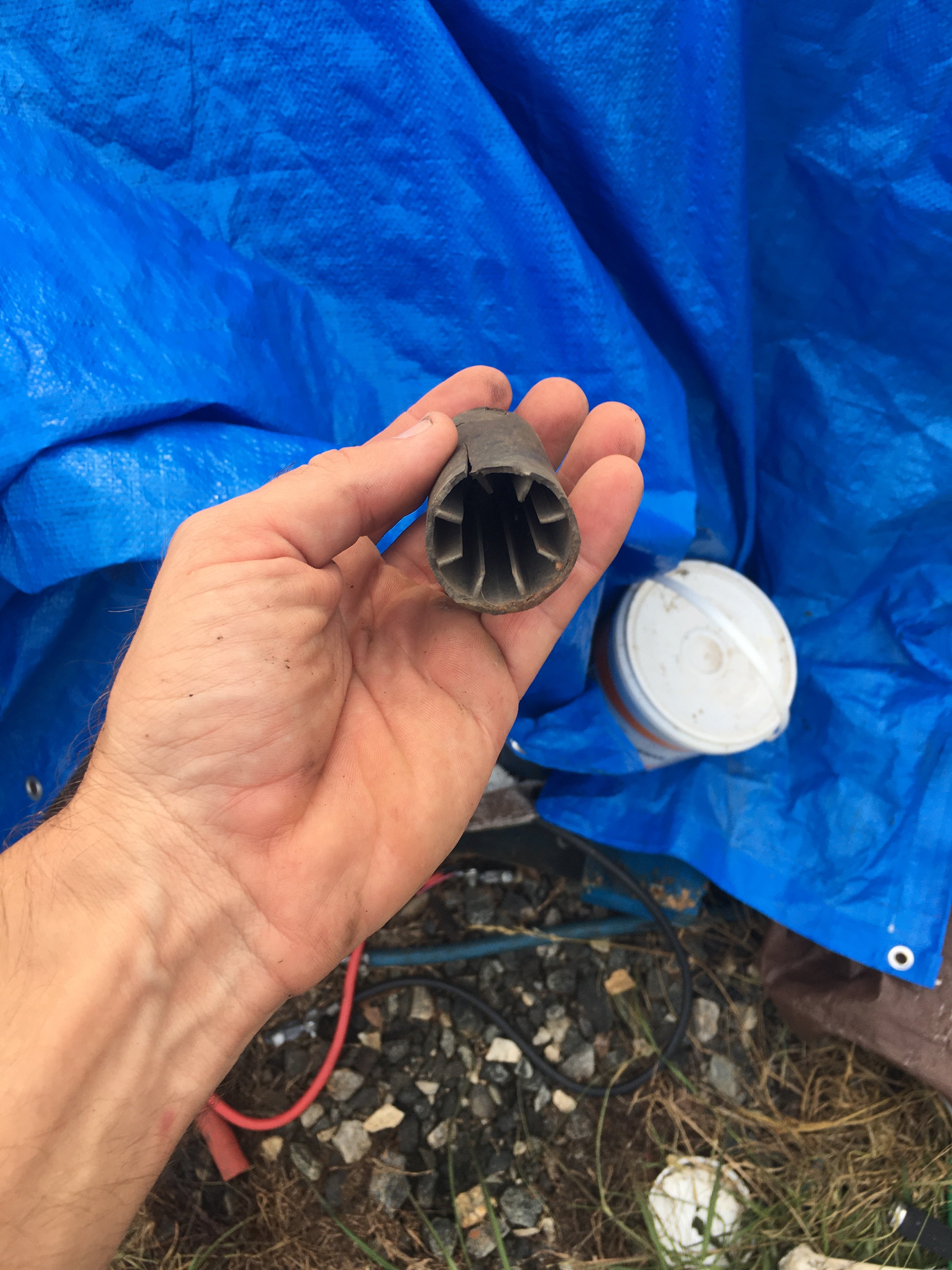

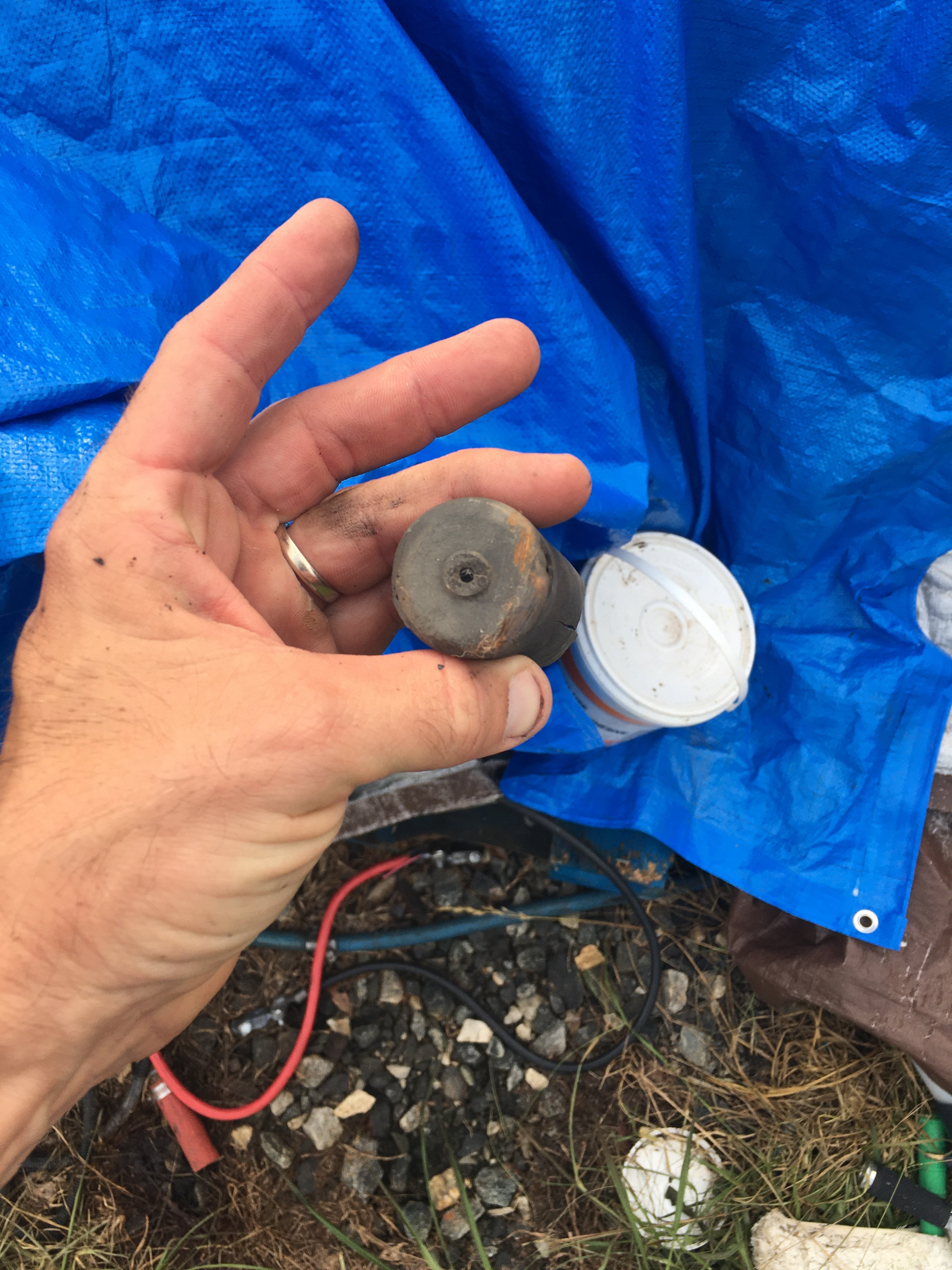

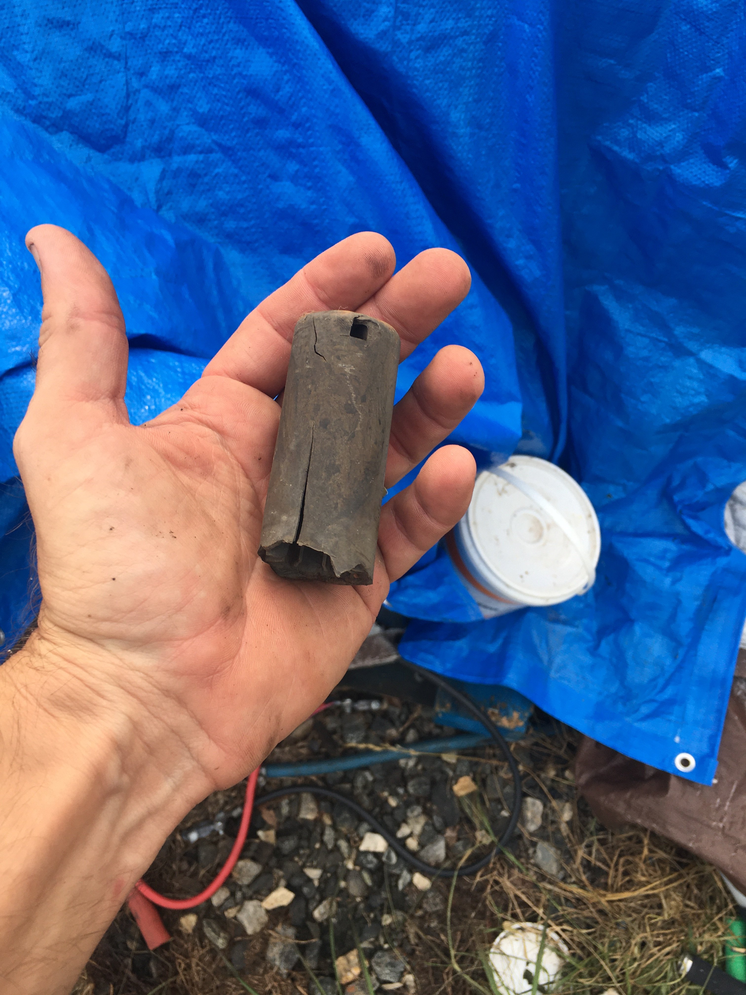

and on my spare parts machine, I discovered this thing sitting in the silencer when I removed the blower a few weeks ago. There's no way it would've survived in one piece if it was sucked in through the blower. It had to be purposely put in there to do nothing but rattle. If the truck mount won't stop rattling, just go buy another one.
