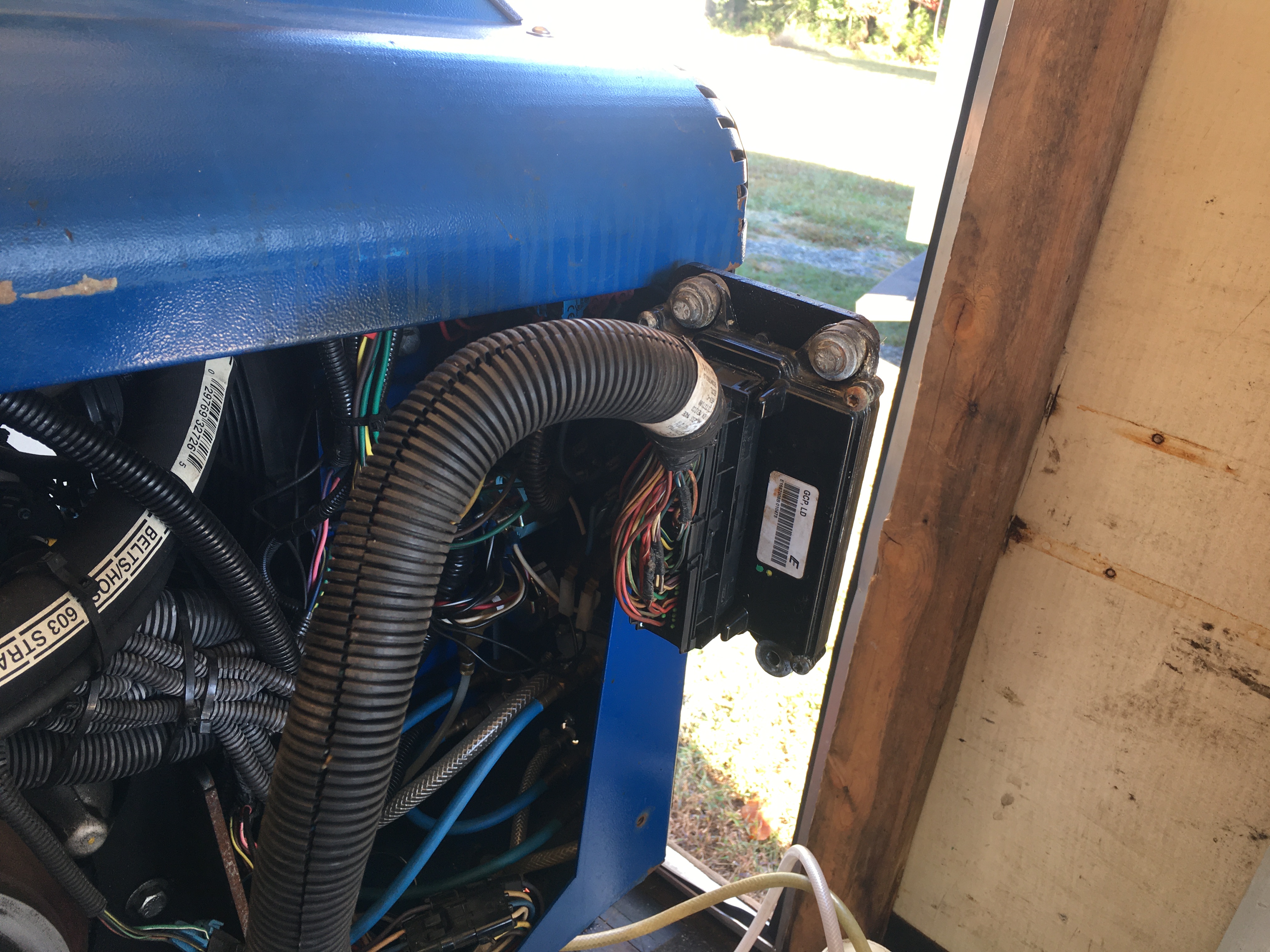

I really like the eurotec burners small footprint, burn clean, problem free. Guy i got it from said it did, we relocated the computer it was originally mounted on the upper shroud above the exhaust manifold, not sure what the engineers at blueline were thinking with that one lol
I really like the eurotec burners small footprint, burn clean, problem free. Guy i got it from said it did, we relocated the computer it was originally mounted on the upper shroud above the exhaust manifold, not sure what the engineers at blueline were thinking with that one l0l

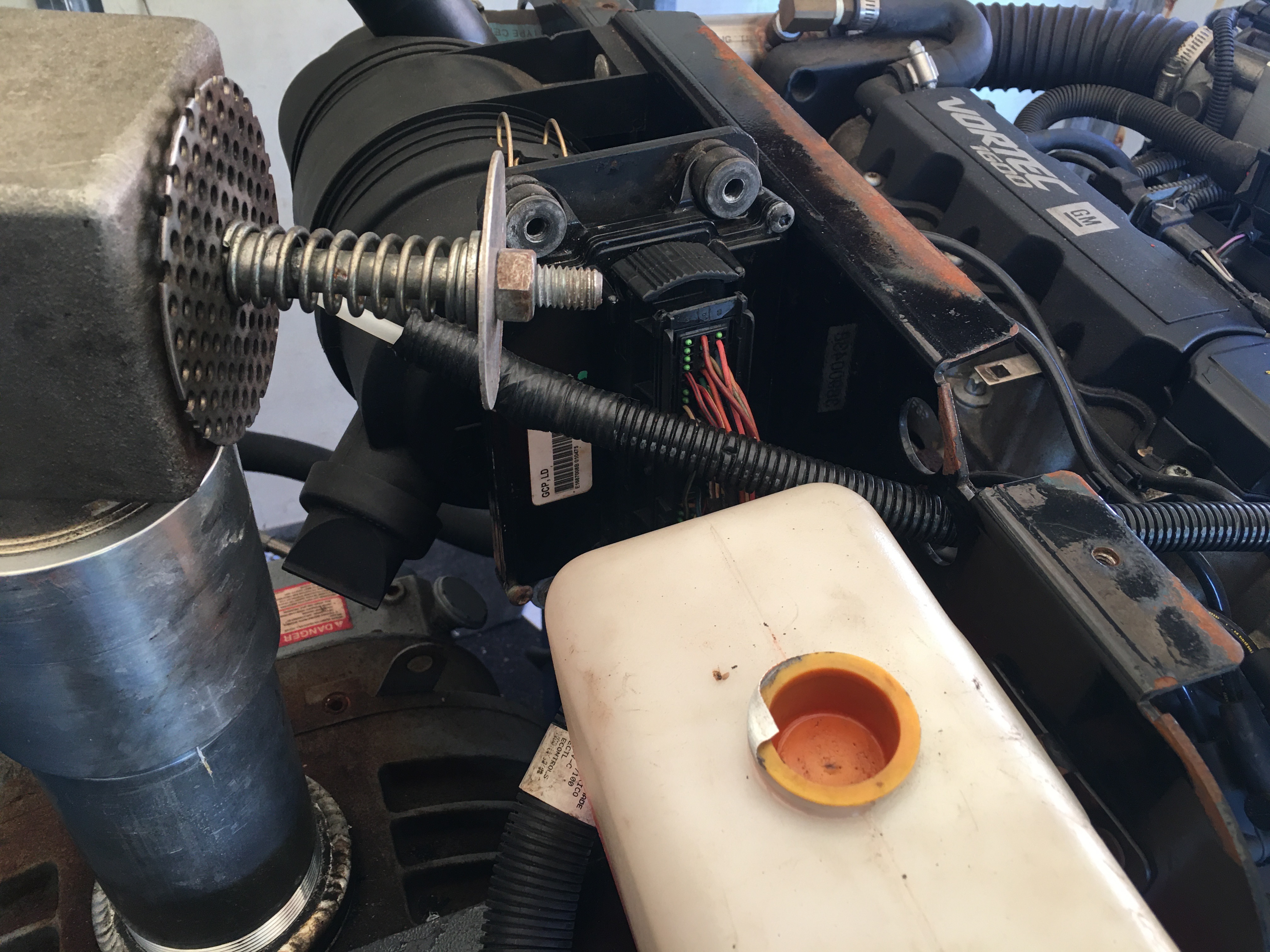

Performed good while cleaning bowling alley carpet yesterday, until I had to empty the recovery tank. 5-10min later, I went to start it back up, the light was blinking, and it was bogging down. So I ran it on full throttle for about 5min and it cleared up, running smooth again.
I'm assuming the computer (where it's located at) got too hot while the machine was off sitting hot, and when air started moving again, it got back to normal.
Where's a good spot to relocate this computer?

I’m hoping to relocate it this weekend and see if it fixes that little hiccup
Brother i completely forgot to get a pic this morning, but we mounted it under the top shroud towards the front it fits perfect in there and the engine fan draws air across it, ill try to go into the shop tommorow and get a pic for you. Unistalled and pjlled the boxes on 2 vortex units today been going since 4am and just finished fml its been a long day.

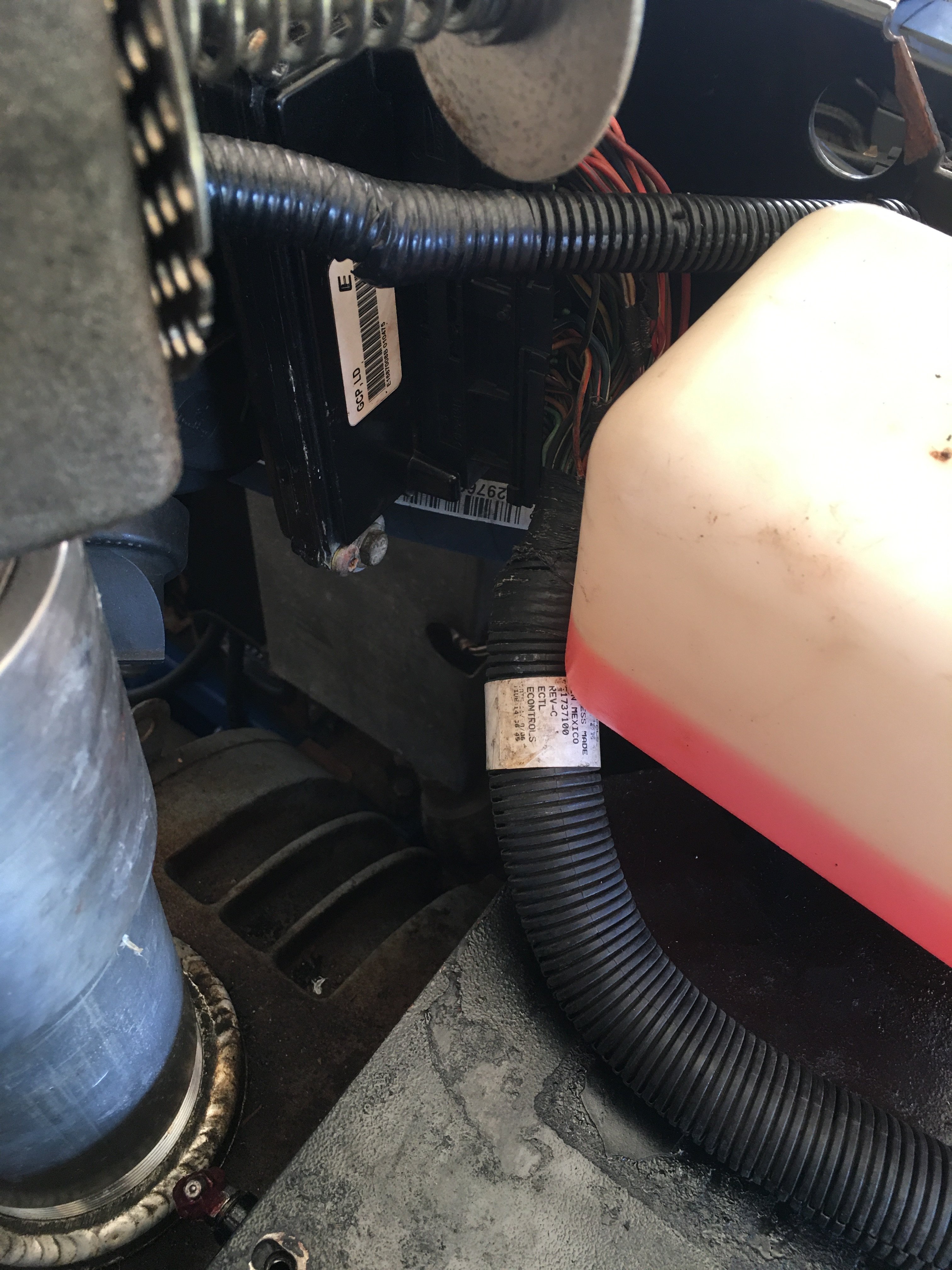

Is this the area you’re referring to? I can’t picture any area under the top shroud

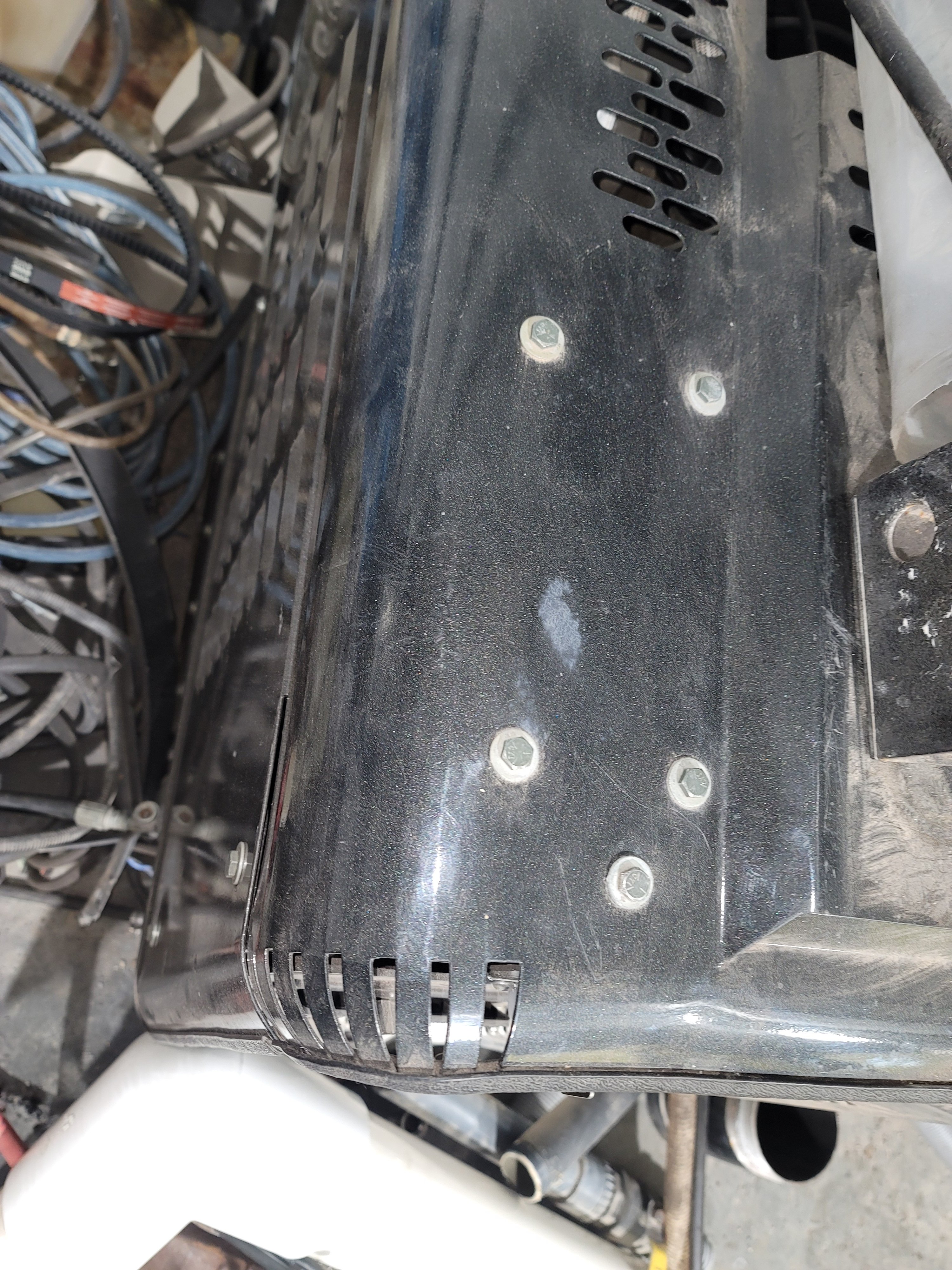

Its mounted under the front left side of the top shroud. Sorry for taking so long to get this posted
Perfect. Thanks for the info
It looks like you didn't use the mounting place from the 5 bolts I see. I was trying to fit the mounting plate underneath it, which made it doable, but awkward
