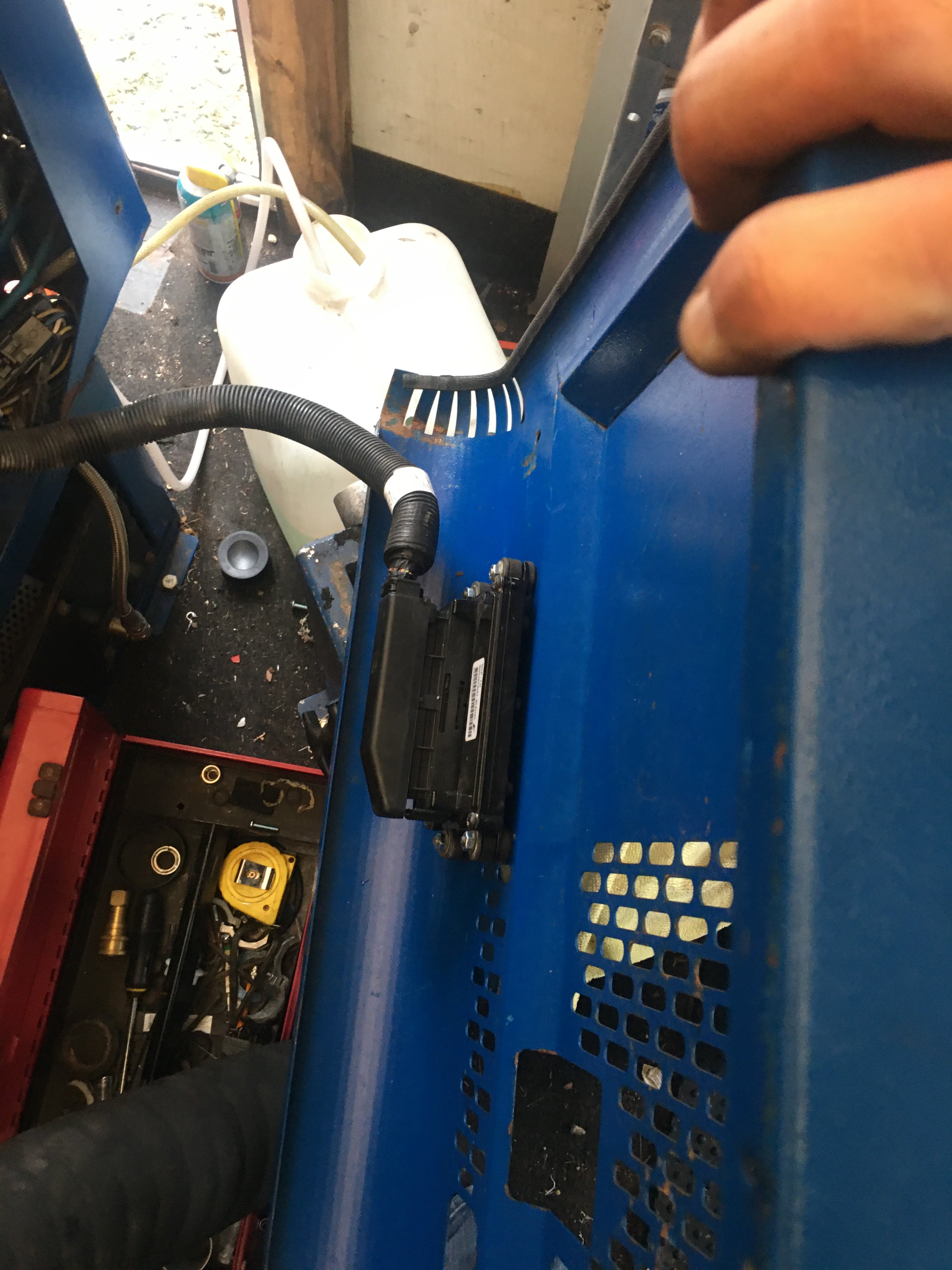

I’m taking it to the forklift later this week to move it. Rubber mats underneath are getting pulled up.
The waste tank was behind it but I think I’m gonna move it to the left side of the machine for better mounting space and ease of access to the rear and right side of the machine.
The van needs a power steering fluid reservoir, a tuneup, and a new rear door
As for the tm, the water pump needs tlc, and the 185f thermal relief valve needs replaced. 🤞. Once I get it completed, we’ll see what other issues it might have

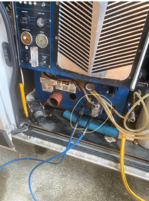

i also moved my chem pump to the front of the machine to better access the diaphragm.
Does anyone have a way I can get the correct fuel pump at an auto parts store? I think this pump is bad. It's only putting out 40psi and the spark plugs are burning lean. I think it needs 55-60psi

Update:
I was under my thermal wave all day yesterday, replacing everything in the fuel system. (fuel pump, filter, and all fuel lines, and vacuum hose line on valve cover) The previous owner used transmission fuel lines, and a no name, incorrect pressure fuel pump, and caused it to almost catch on fire with it burning lean, causing my entire exhaust system to glow. After several fuel pressure tests (the fuel pressure gauge from Harbour Freight crapping on me) and finding the vacuum leak as well, I think it's finally ready. I"ll find out tomorrow how well it runs. $250 worth of money spent
I thought I had the overheated exhaust pipes dilemma fixed, but now I know it's fixed
I just pulled the van out of the shop prior to this problem. (rear engine seal, power steering guts, timing gear box, exhaust pipe doughnut). Another $2100 burned in the wallet
Correction: I went and did a job and the damn exhaust manifolds started glowing again. Did another pressure test and it only reads 35psi after fuel manifold. It puts out 65 at the pump. There’s a MAP sensor on the fuel manifold. Is there a way to test that?

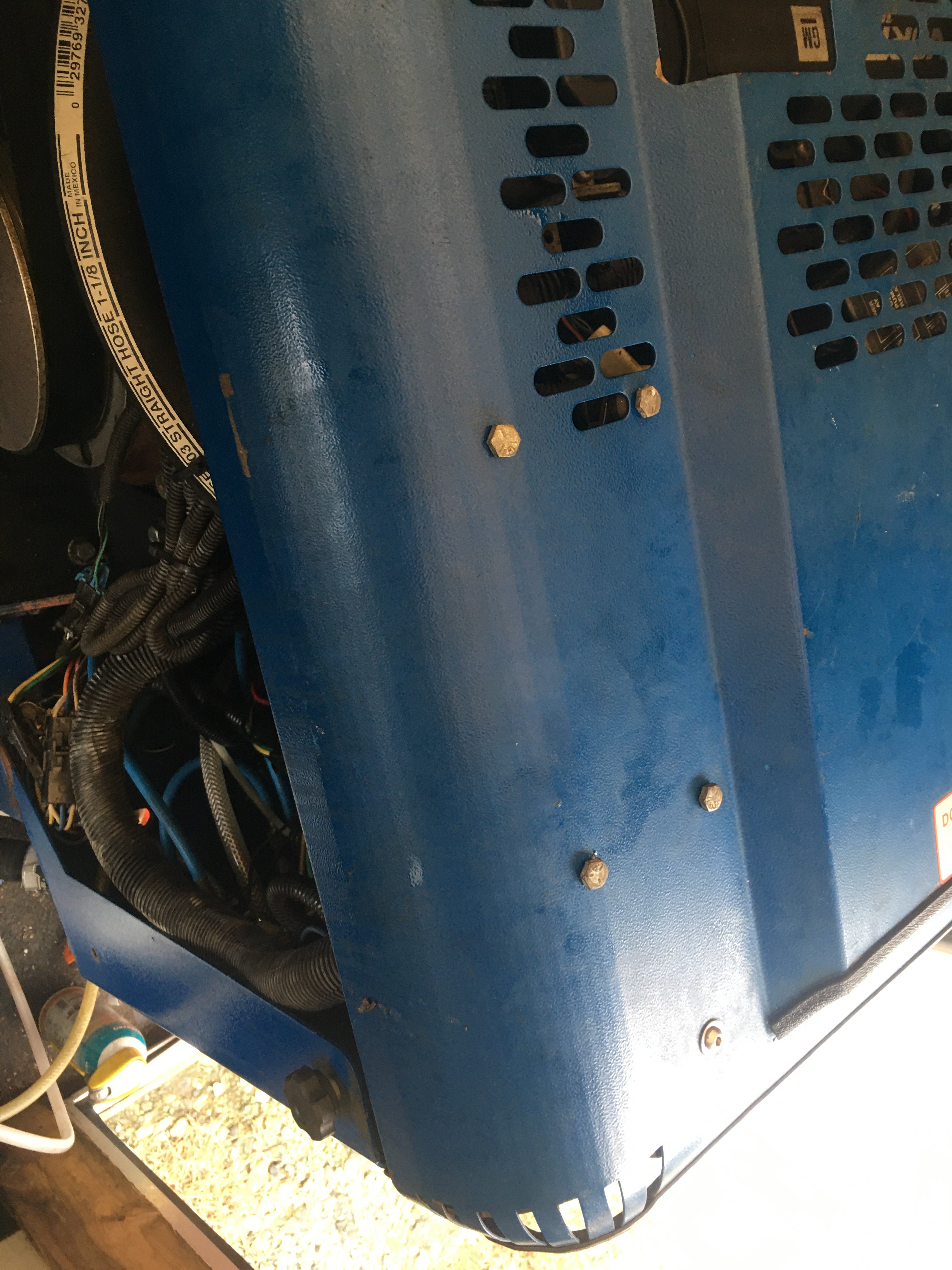

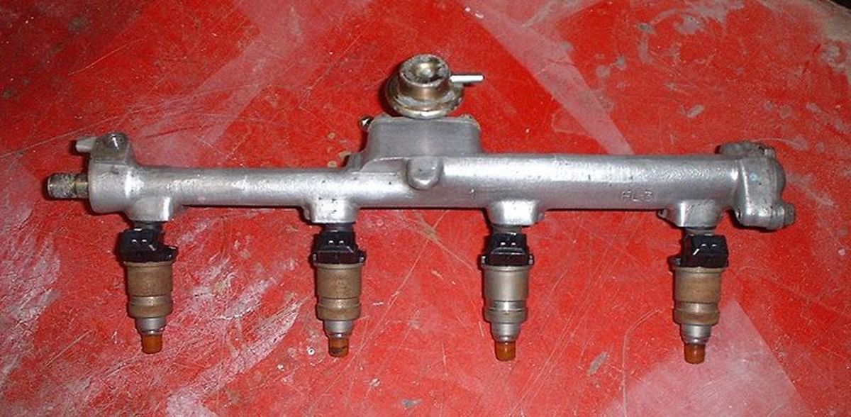

Another Correction:
That's not a MAP sensor, it's a fuel pressure regulator. It looks just like a MAP, but the manual in the Everest (which uses the same one) shows it's a FPR.
But Oreilly says it's a MAP... https://www.oreillyauto.com/detail/...-absolute-pressure-map-sensor/bos0/0261230112
And Justin sent me an article on this subject Jan. of 2022 when I first noticed this problem. I should've addressed it then, but I had so many other things to do to this setup a year ago. (Just read about it in the previous posts, lol)

The pressure needs to be about 55 and it tested 35 right before the injectors. The computer is Zeems and I think the fuel injection is something like PFI, I"ll check. Yes, it's the gm 1.6
There's only 1 light and it says it's emissions light right next to the key
Where did you get the 55 number?
Can you post pics of the FI system on it? or make a good vid. Just want to see what injection system is used...
Is that light on? That is a MIL. In the olden days you jump to pins and count the blinks...some have it on the computer
14,600
I"ll post a video shortly. I didn't see any light on. Which pins to I connect? On my everest it's the brown/white wire to ground, but I don't see that wire on this pin.
Changing the FPR/MAP sensor didn't help
