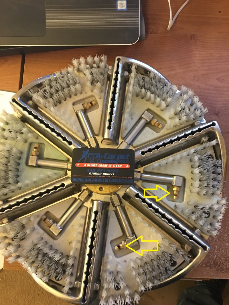

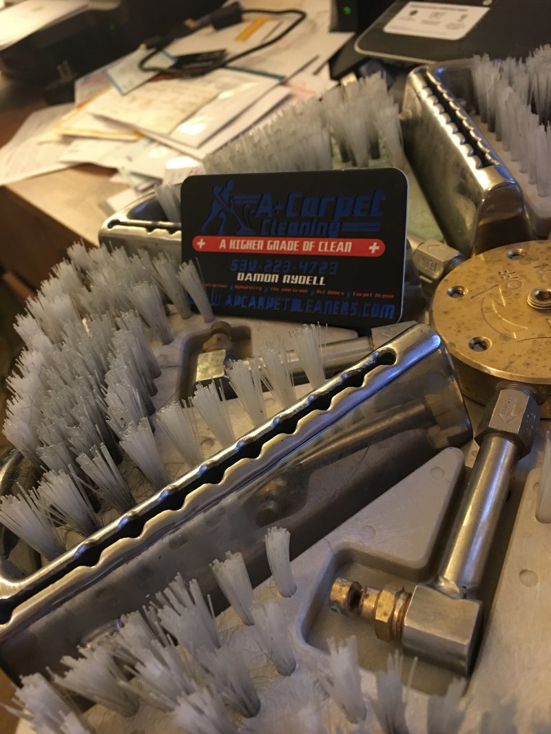

Have you noticed how some of your jets are blown open? is that by design or just cheap thin walled brass getting tortured by your 3000 /270Âş 870?

This is a new head sent to me. All the jets seem to be working fine and spraying evenly. But now I'm going to really have to look close. So far it's good. I do keep extra jets around just in case

those are new, go look at the head, sure looks blown open in those pics

On a happy note. The Trex head is doing great. The jets seem to be fine. On close inspection I am seeing some black residue around the spray holes and I think that is making them look blown out.

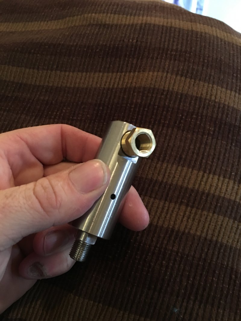

Ok. This is why my next big purchase will be a Mytee ECO-17 Orbital. I guess John LaBarbera saw my swivel leakage video and he sent me a new prototype swivel they are testing out. Thanks! It is truly appreciated and never expected.
