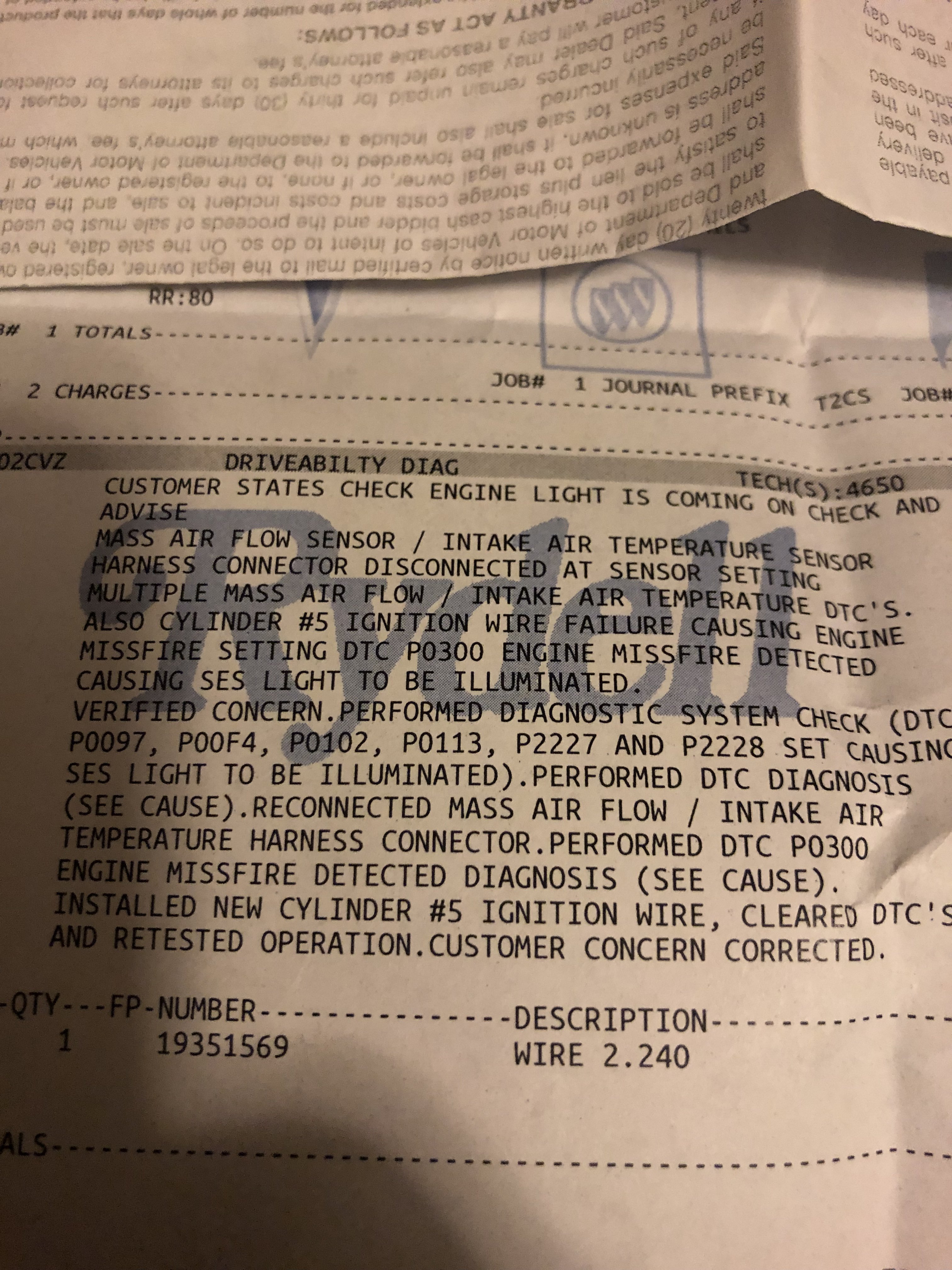

It’s weird we did check
Codes and it was a coming back a bad gas tank pressure sensor we reset the computer and filled the tank and waited to see which sensor it was when the check engine light came on. Also at that point the alternator was running 15 amps and the battery was sluggish.
New battery and sparks plugs was great. The guy who did that worked accidentally left the mass air flow sensor unplugged.
That’s when everything went haywire and I took it to the dealership.
They were bozos and refused to touch it with after market parts on it.

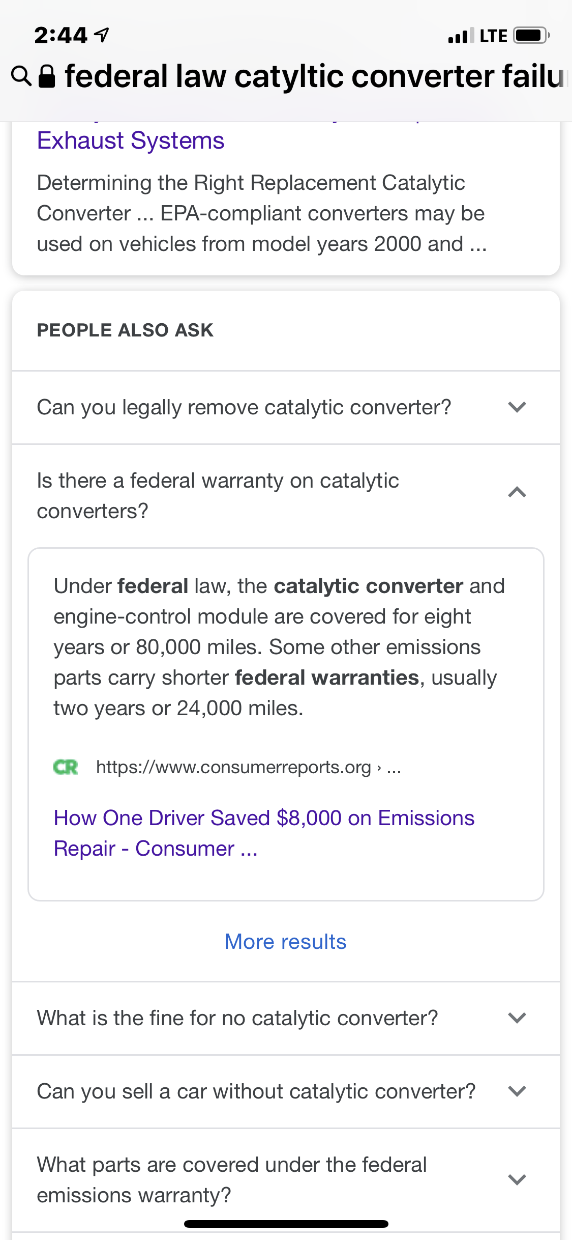

Lastly there’s still a good possibility I’ll have problems with the catalytic converter pray it ain’t so!

The unplugged mass air flow censor would cause it. But there was a some
Serious misfires all the time which isn’t good for a catalytic converter either.

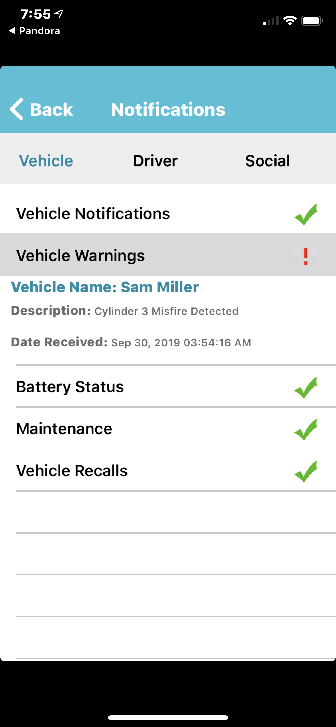

Originally it was cylinder #5 misfire now it’s #3 misfire
That’s the code my Vyncs gps device came up with

Put on the one wire for today reset computer and it runs good $40 cash for my mechanic to help me replace it
