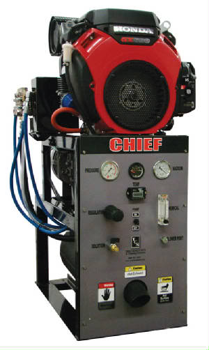

TCS Chief: $14,995.00 Free Install
Honda GX690 Engine 24 HP
Sutorbilt™ 4M DSL @ 331 CFM vac blower
General Emperor HTX 1810S solution pump
Little Giant 3 HT 120,000 btu @ 200+ degrees heater
250' vacuum hose w/ reel
250' solution hose w/ live reel
100' supply hose w/ live reel
100 gallon recovery tank
55 gallon fresh water tank
Stainless steel 2 jet S-bend wand
Under Van Mounted LP Tank System
$14,995 Complete - Applicable shipping & taxes not included. DOT approved fuel tap may be required.

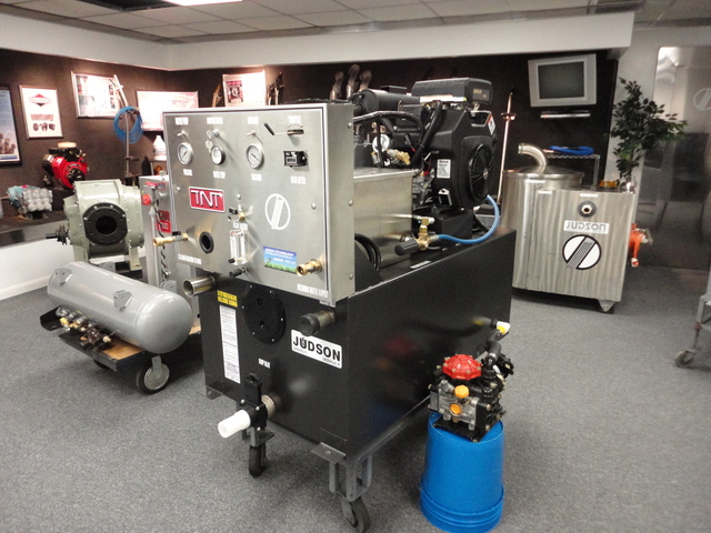

Includes:Judson TNT $14,995
120 Gallon Stainless Steel Waste Tank
Kohler 20 HP Engine
Roots Dual Splash 45 Blower
Cat 3CP Pump With Clutch
Little Giant 3HT Water Heater
150' Of Vacuum Hose
150' Of Pressure Hose
Vacuum Hose Reel
Pressure Hose Reel
Wand
Factory Installation - $850
Crating & Shipping Charges - $400
Both machines are similar. TCS provides more hose and a fresh water hose.
TCS also gives you a fresh water tank and free install.
Judson, the price is a little higher in the final price, due to install. And alot of the extra price comes down to this.... The Judson uses alot of Stainless steel. Their waste tank is stainless. TCS uses Aluminum. so the Judson's tank will last much longer.
Both Machines are similar and with in a few thousand dollars in price.
Can anyone else think of anything? Les? have anything to add? These are the machines of the future

You are correct. The TNT costs around $2500 more to produce than a comparable unit with an aluminum recovery tank. So as far as Judson versus TCS, you can see that Judson is giving you the better deal. The $850 install does include the fuel tap and the liability of the installation.

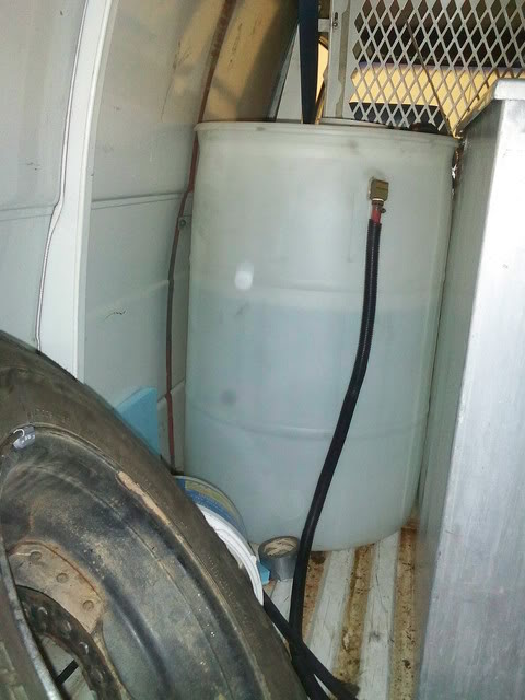

On the TCS unit, the fresh water tank is a plastic 55 gallon drum. Once the float valve is installed it only holds about 45 gallons.
We feel that this is not enough water to clean an average house. Judson only uses water tanks that are designed to be mounted and transported in a vehicle. As we all know the water well is pretty expensive; around $850. A lower priced alternative is to use an Ag tank from Tractor Supply. You can get a 130 gallon tank for around $300.
Judson has been producing production truckmounts since 1970 and we custom build units to suit any carpet cleaners needs. We offer any engine with any blower with any pump combination. If you feel the extra $2500 for the stainless is not worth it, we will gladly custom build you a unit with an aluminum tank and pass the $2500 savings on to you. It really doesn’t make any difference to us. We will still make the same profit we would on a TNT. That would give you a complete custom-built system from Judson with comparable performance to the TNT for around $12,500.

please don't tell me that's a TCS OEM fresh tank install :shock:
is the duK tape on the floor to finish "securing" he fresh tank??
..l.T.A.
48,418
Prattville, Alabama
No, that is not a TCS install. It makes me sad to think that Les has been hanging out with Satan long enough to have been influenced by him to that degree.
Come on Les, you are personally better than this and your machines should be respected enough not to make it necessary to stoop to that level.
