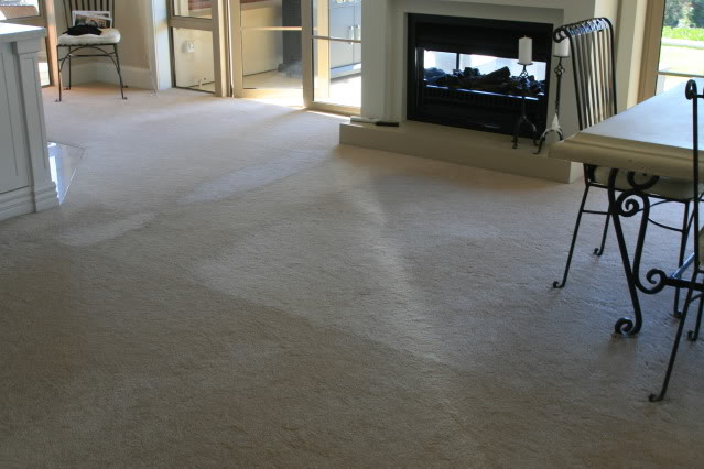

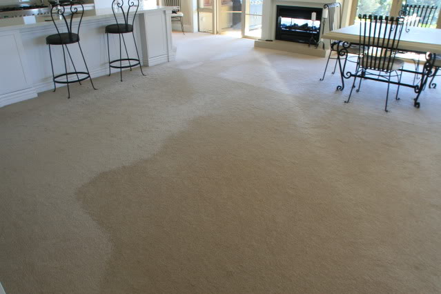

I'm working out of town today, but have just walked out of such a job. High end 100% wool cut pile tufted.
Ill put some photos up later on.
If it was static or airflow, why does it sometimes stop at joins and not continue through into the next width of carpet.

Permanent Pile reversal from this morning's job.
I was there looking at filtration soiling claim.

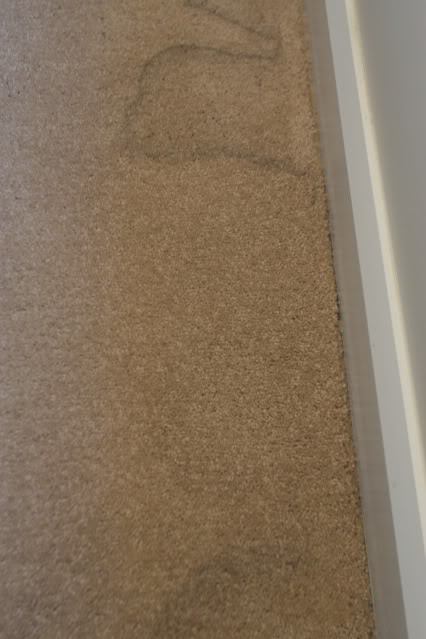

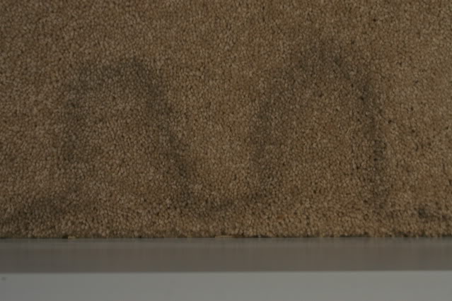

The carpets above are 3 years old and uncleaned.
My last claim was a similar situation but only a year and uncleaned.
I have heard someone say that if it appears in a doorway, place a piece of teh same carpet beyond the doorway and the same line will continue. I guess that doesn't eliminate many of the theories above, but I find it interesting in the photos above that the PPR didn't continue over the join in the carpet.

I would request a gravity map for that one in the pics.....or just have the owner stand in each spot and ask if they feel lighter:biggrin:
