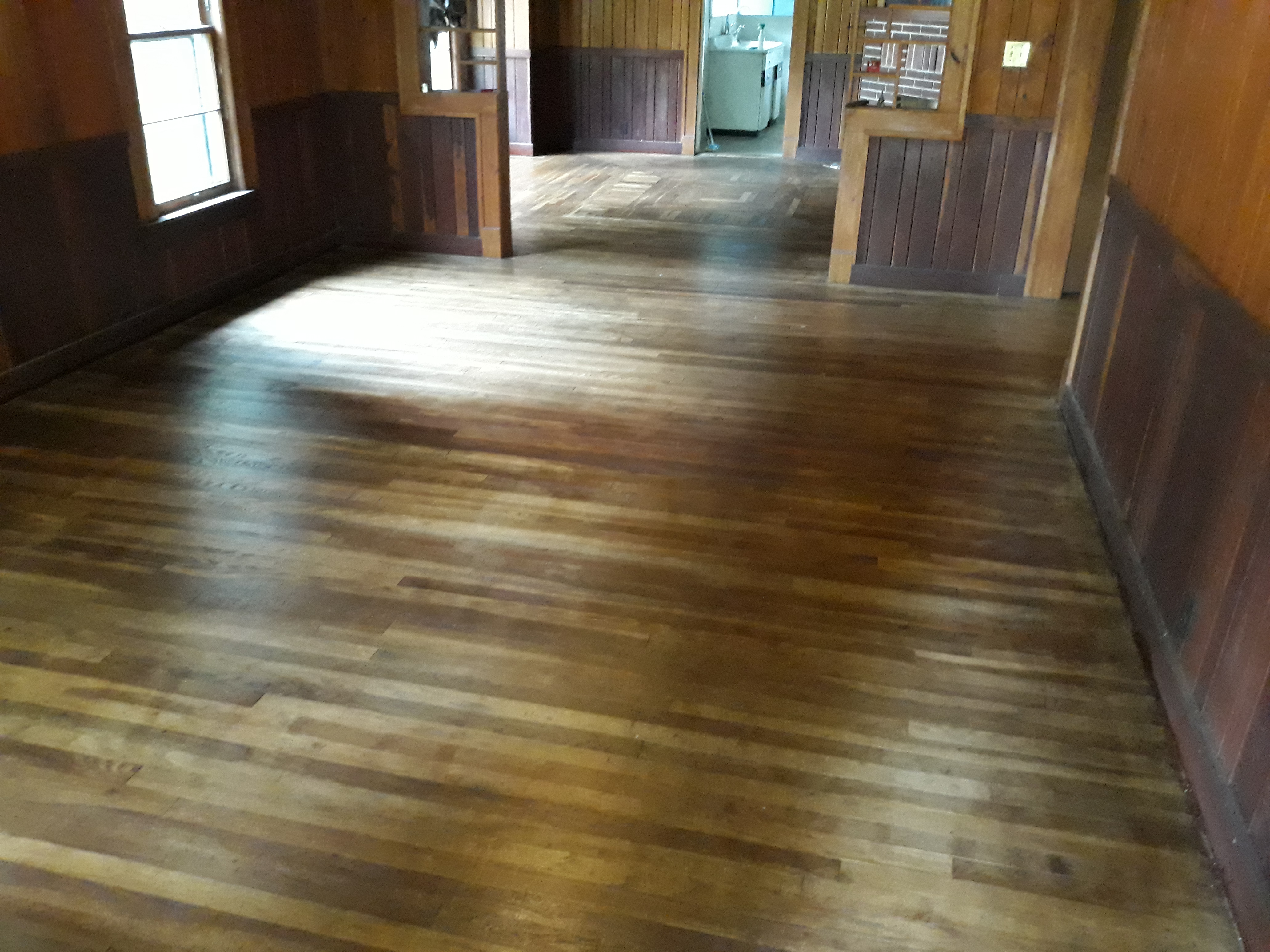

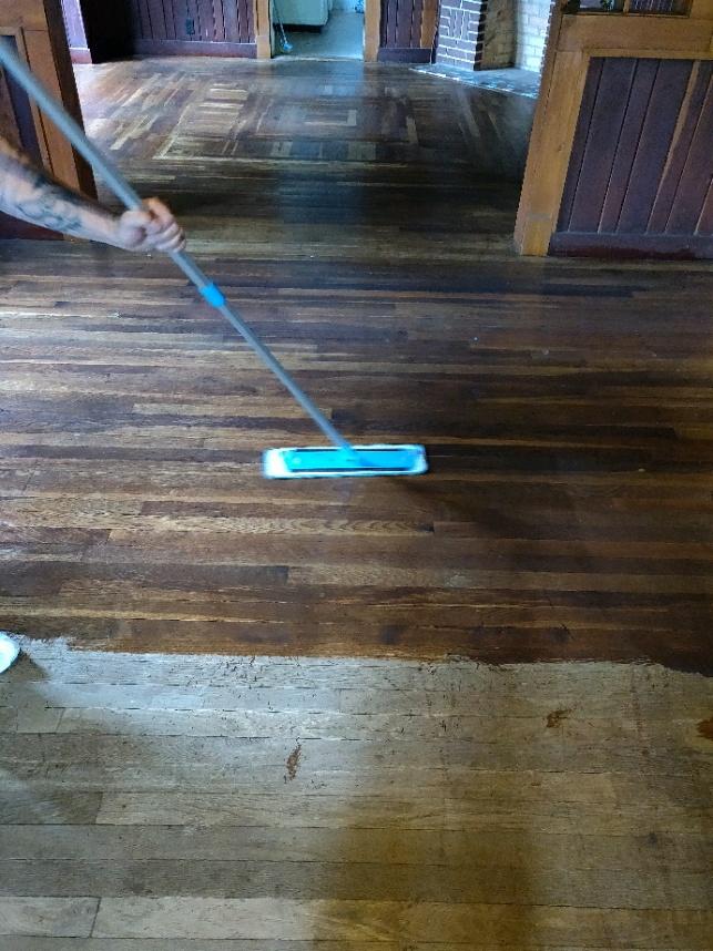

Will this machine clean hardwood floors just as good as dirt dragon or minuteman?
What's your experience with these machines? I've already taken the advice to not get Powr-Flite's model, which was the original question on this thread.
And the only difference so far with DD and T1 is durability, not performance. So I promise I won't throw it in my truck at the end of the job and I'll just pay $2475 DD, instead of $4$$$ almost $5k for the T1.
And as for my customer, they know this floor needs a total sanding, but they don't want to spend $5k to have it done. He's shown me a few places that's gonna be cut out and replaced. So there's no unrealistic expectations. I told them the Gloss they requested is gonna magnify each of these areas that I showed them, and he didn't change his mind. He wants it to magnify I think, because there's one area that's very damaged that they don't want to be fixed because it was caused by the golfer's cleats in the early 50's and it adds to the original design of the place. It does have a thick poly on it so it's not bare wood.
I swear you guys think I'm a total dipshit sometimes. I'm just looking for a more efficient method than the previous screen, clean and recoat, and this Basic liquid bonding seems to be that way. If it's not, I'll admit I was wrong and I hope it will help some lurkers out there make a decision on a similar position I'm in.
And Mike was dogging the whole "hardwood machine" process with all the machines until his SS buddy chimed in about using the T1's. I didn't see him calling CJ a dumbass for buying dozens of those for his franchise. So you see why I'm a little on the defense

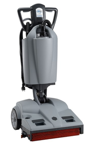

I think the Karcher machines are the best built of the wood and floor cleaning machines. They are also the most expensive in most cases. The Lindhaus LW46 is the equal of Dirt Dragon and similar machines for significantly less $.
91221
It retails under $2900.

I watched about 5 of those Youtube videos of those machines because they do look impressive with the brush going up against the base. But I was dissapointed in the quality of the video. I couldn't see how well it extracted all the water and the camera was more focused on the front of the machine like it had some new Transformer design, and they were more focused on the lady in dress shoes operating it. Is there any professional videos on it besides them cleaning a clean floor at a car dealer? I really considered that machine before I pulled the trigger on the other

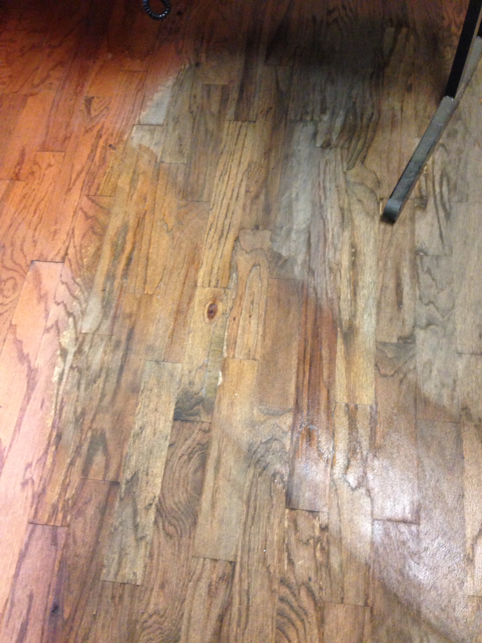

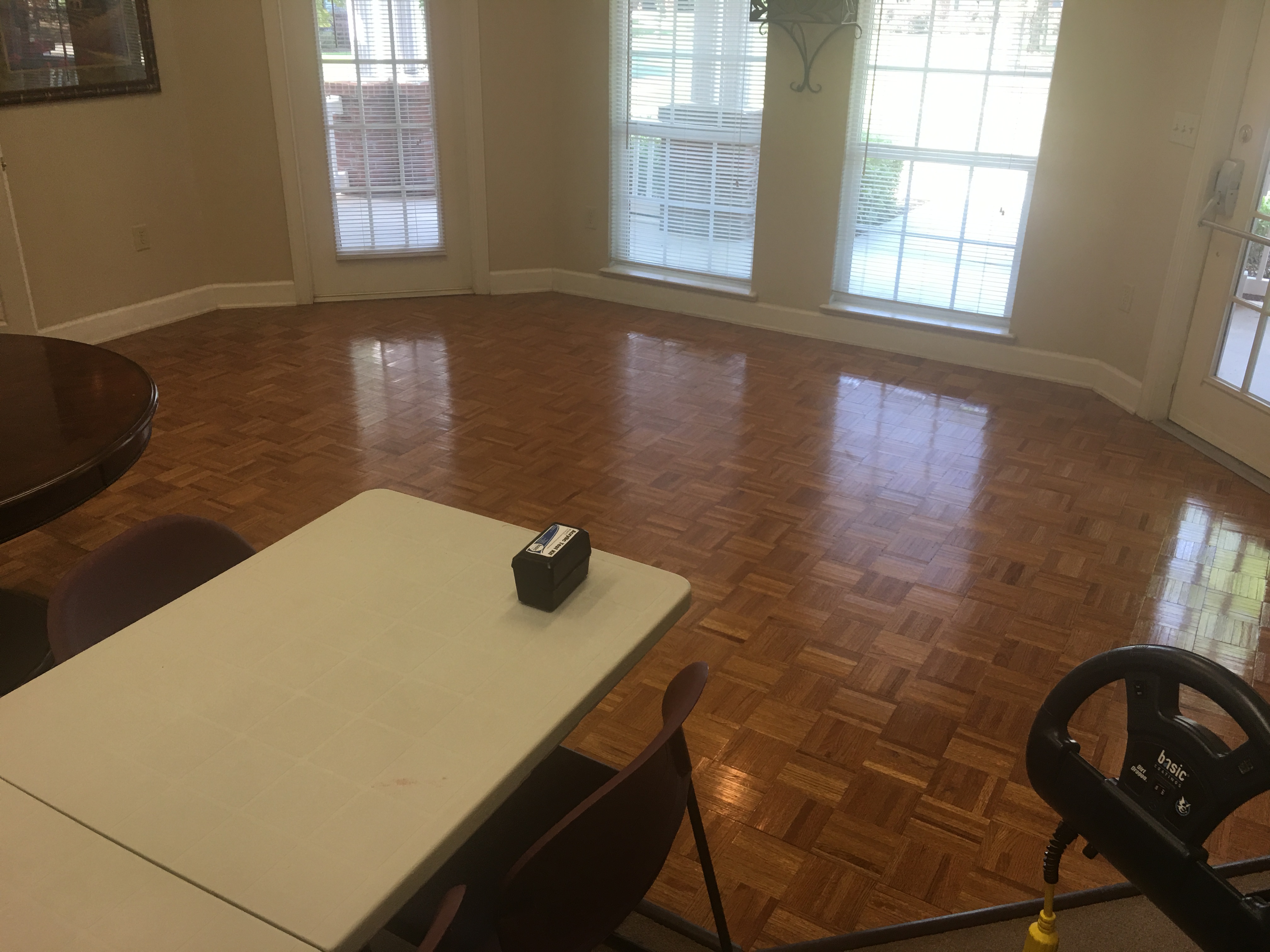

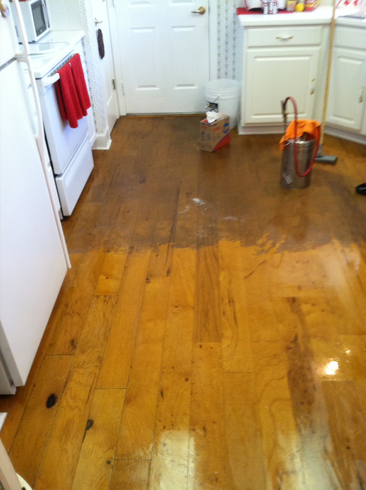

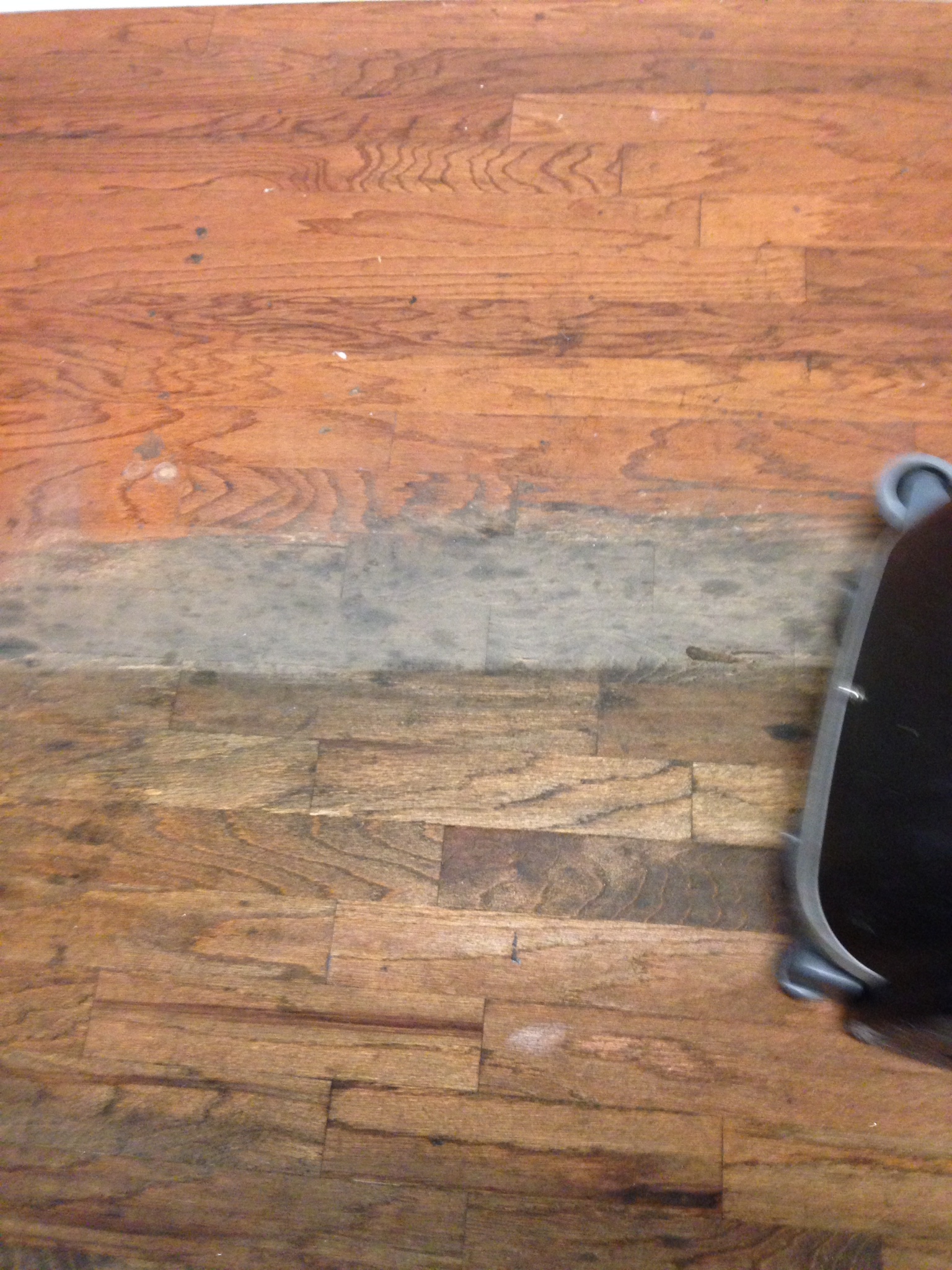

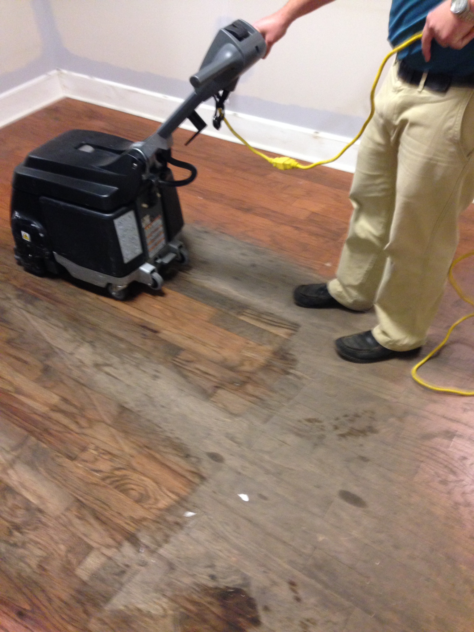

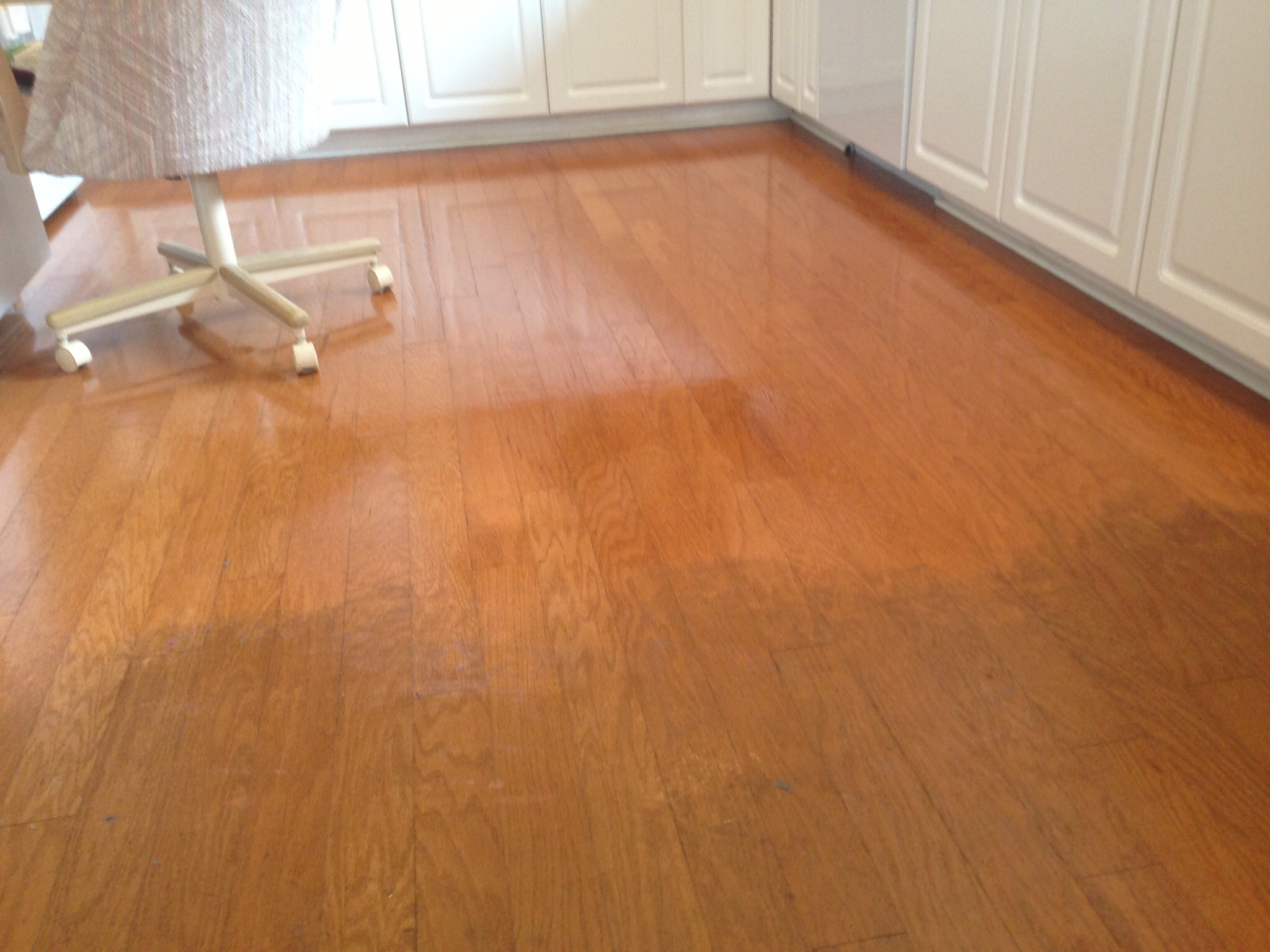

There’s just no need to state the obvious in my case. They all just expect better from you than those bottom feeding Steemer smucks. 😉
In all seriousness, the machines remove much more soil than a customer can on their own. Are they perfect? Nope but when I leave there’s less crap on the floor than when I arrived.I try to charge appropriately for the service I’m providing and be clear with the customer about what they’re getting for their money.
62AB252D-2566-4C0B-ABEF-131B899C3135.jpeg 926AC4EF-97FC-4CB3-9A25-5E4DA2F8631A.jpeg E6294909-34A6-4EFF-A00E-63D199468869.jpeg 926E5ACA-87DF-45E1-A54B-162355723142.jpeg 7EBA4171-141F-4006-ABBE-96AC9E1BF4C8.jpeg D0B99687-841C-460F-AB4C-2AF45F51F391.jpeg 94744979-099E-4660-910F-7D478BA81309.jpeg
I don't know of any better videos of the machine in use.
I have used the smaller Lindhaus LW38 several times. The performance on wood was fine. It also worked on LVT and LVP and on a polished concrete floor. I used the LW46 only once, mainly because they are in such short supply one was not available to test out before I moved to the boonies. It seemed to perform just as well.
Many Interlink Supply locations have one on the floor now that can be demo'd. Try it out yourself. However, because they are popular, they were in back-order for several months. Just now getting display models out to distributors. So, not all locations have one.

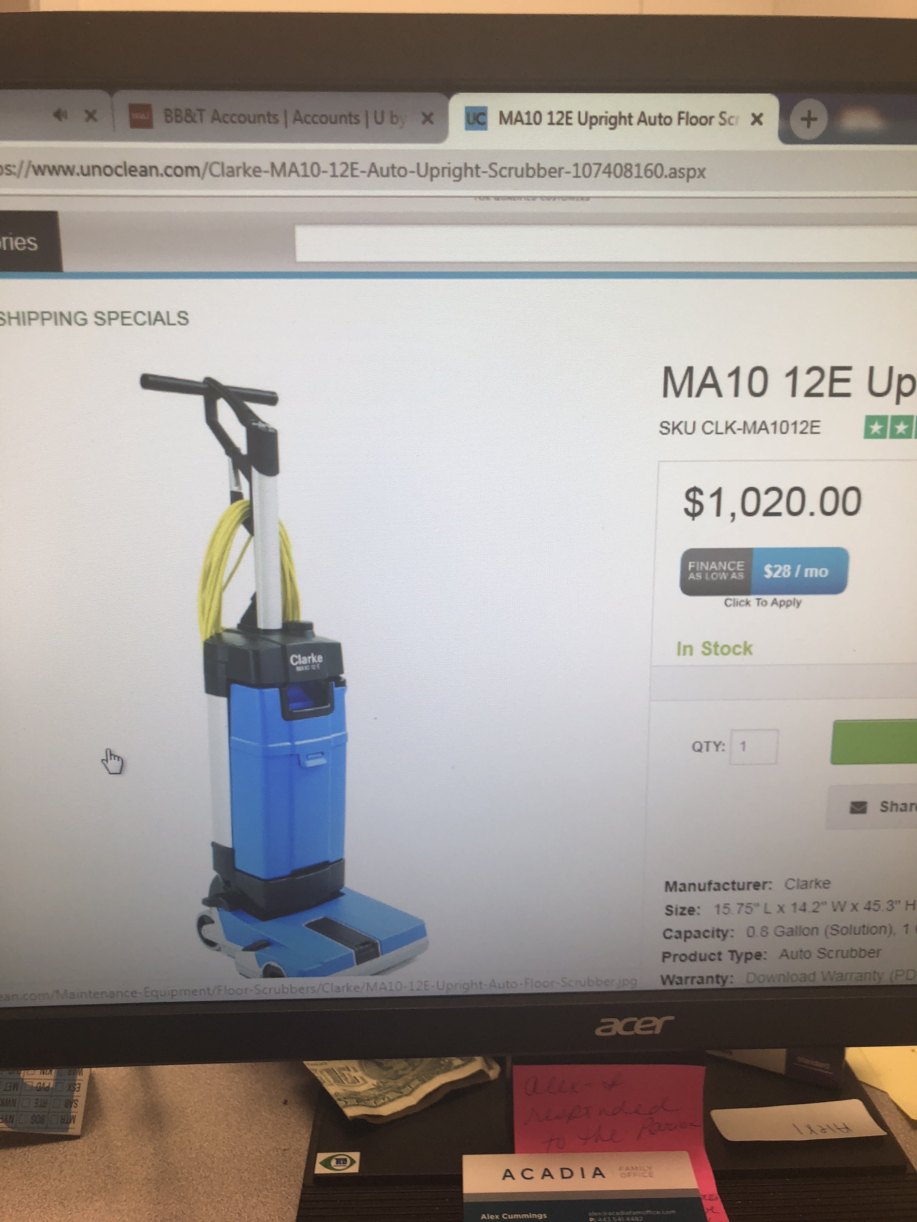

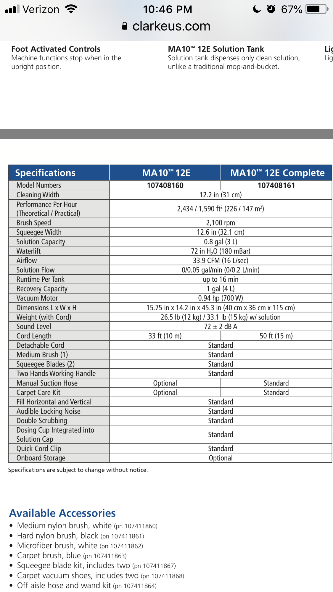

this should arrive july 2 - ill let u know how it does. google clarke ma10 there are some nice vids on it . i also had been doing the red. pad/mop method
S
susclean
That caught my eye also. How big are the tanks?
not big - .8 gal solution, 1 gal recovery
my thought is to spray the cleaner down, red pad, and use the clarke to suck up/rinse
most jobs i do are around 400-500 sf (dining room kitchen foyer hall etc)) and im hoping this will do that w 1 to two tanks worth
