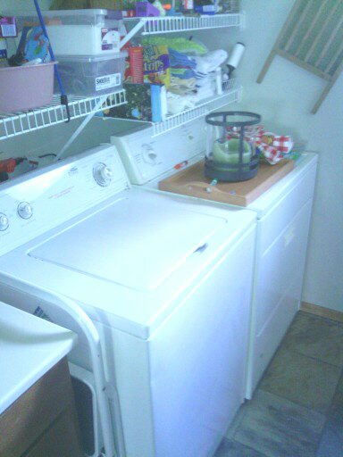

the ETM is an excellent choice as you can easily access a 220 plug
"easy", eh???
maybe laundry rooms are different in Tx and Mi ???
cause the above pic is pretty typical here
220 plugs are difficult for me to reach in Michigan as you have found in Ohio. I said in the south where the plugs are more common and coded to be a certain distance above the ground and generally easier to access. Sometimes it's best to show the entire quote so as not to cause confusion and bewilderment.
Fort Worth , Texas
Yes 220 plugs for dryers are definitely easier to access than up north.
Here most 220 outlets are at 48 inches or higher above the floor, so you just reach in disconnect the dryer and plug in....
We regularly source 220 for our spider boxes from dryer outlets as it is good and easy power scoure to get an extra 40-60 amps from.
