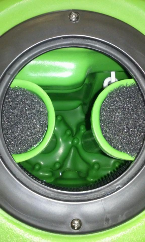

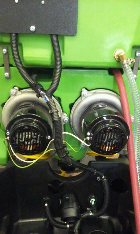

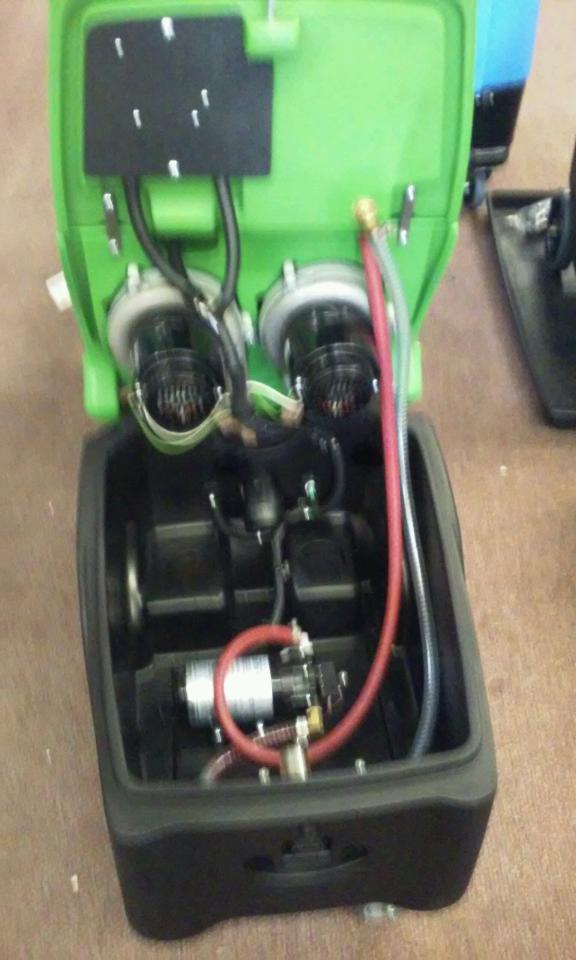

I agree it would be a big hit, but did you know that at cobbcarpet.com they have the Mosquito Extractor that has the dual 2 stage 6.6 vac motors belly mounted just like the Mytee ltd5. I was considering that machine awhile back, had them take pics of the inside and send them to me, i still have them in my phone if you want to see them
Yea, I'd like to check the pics out.
I can't find too much info on them, and none to support that the vacs are belly mounted in parallel, with twin stacks.

Interesting.
First problem I see is that they are NOT offering a dual 6.6, NON-heated, 0-500 psi version.
Foolish mistake.
