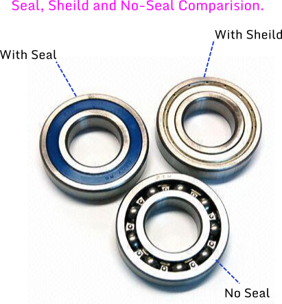

Are the bearings not sealed bearings?!

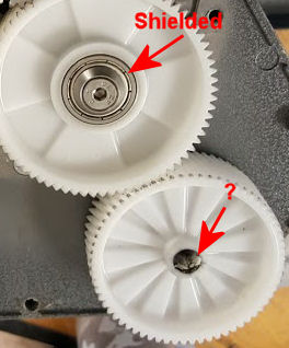

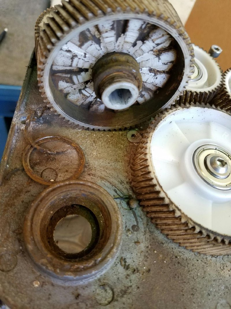

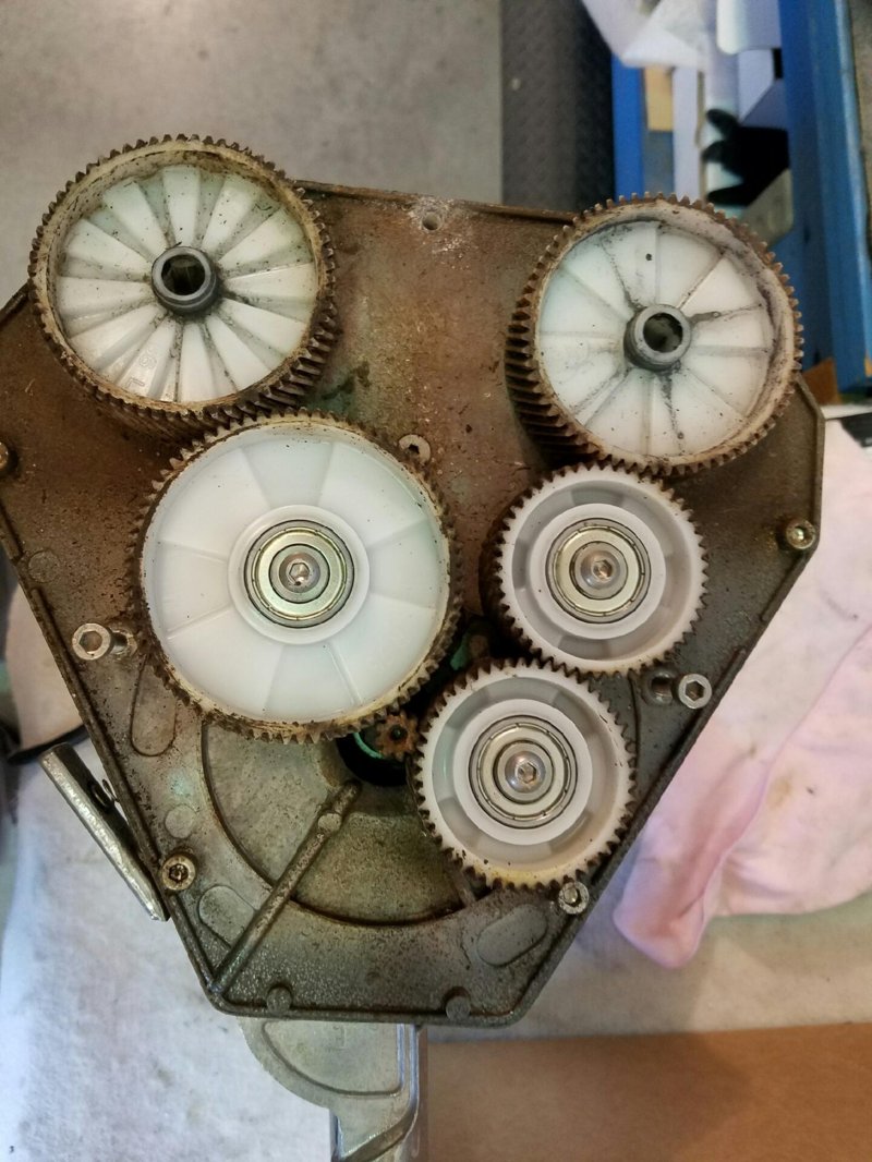

That's an interesting question. Looking at Mike's picture of the gear train it looks like the upper bearings (that you can see) are shielded, not sealed. So now I wonder if the lower bearings (the one(s) that failed, that you can't see in the picture) are sealed or not. The parts list simply shows them as 6003 - that implies a completely open bearing. A sealed bearing would have a part number something like 6003-2RS (2 rubber seals), and a shielded bearing would be 6003-ZZ or similar. If the lower bearings are shielded then they are protected from dust and debris, but not liquid entry.
If the lower bearings are shielded then switching to sealed may help. One report of a problem doesn't mean an epidemic though...

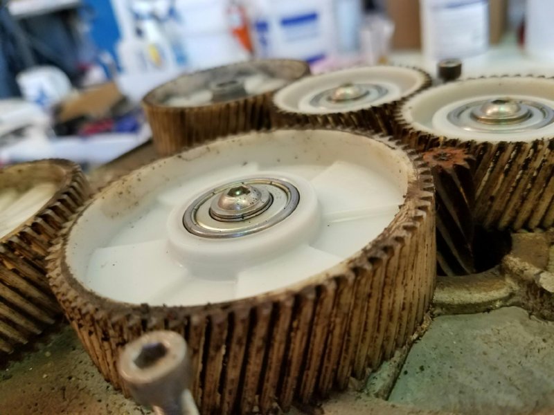

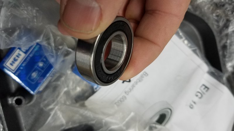

I have some extra Bearings for these units in my shop...I will see if I can find them and post...
I ended up putting new end caps on totally vs try to replace the bearings....much quicker and they were preassembled....plus....6-7 years of use and abuse....I did well with them....

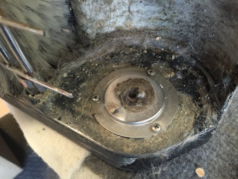

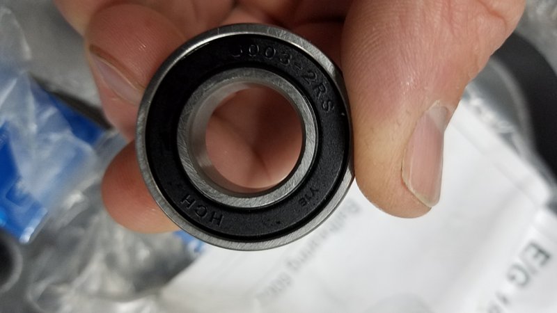

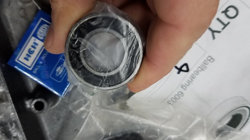

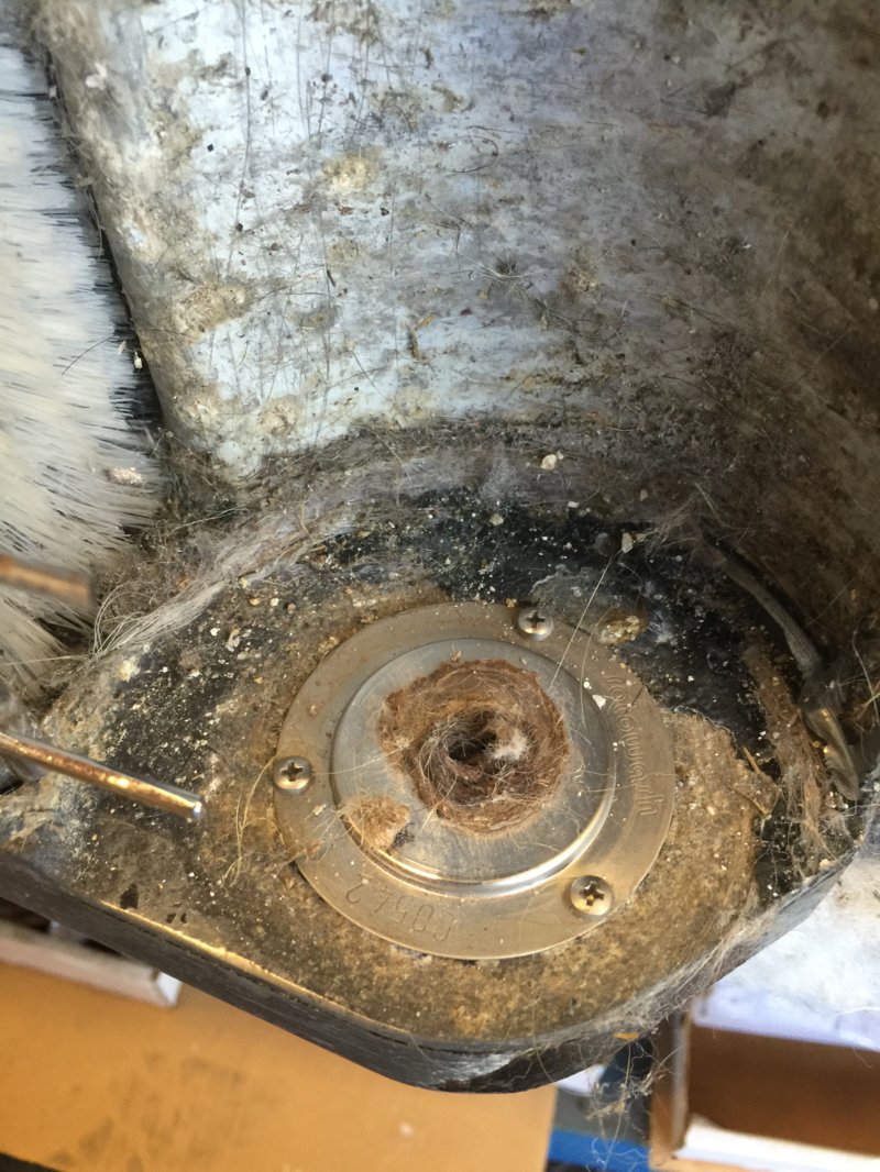

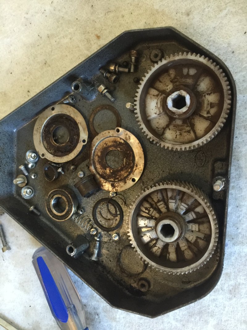

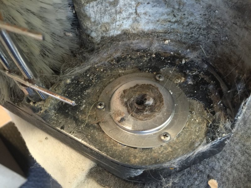

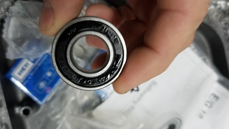

Yes, as you can see the bearings are sealed. The problem is when the machine is allowed to degrade in maintenance levels to a point that excessive amounts of debris and or corrosion gets in behind the those protective plates, it becomes a problem. Here are some pics of the machine after we took it apart... Keep in mind, these machines are damn near bomb proof. It takes a very bad environment for this to occur

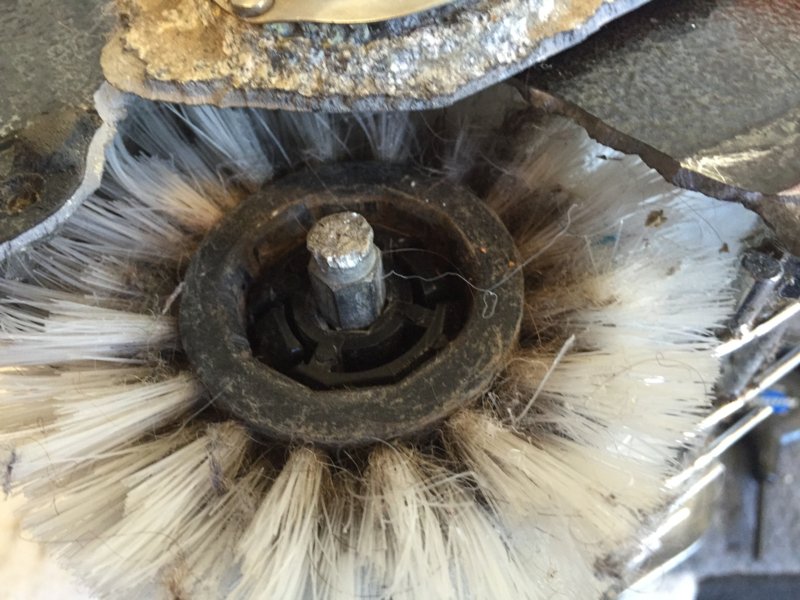

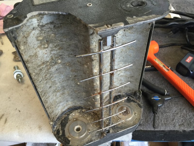

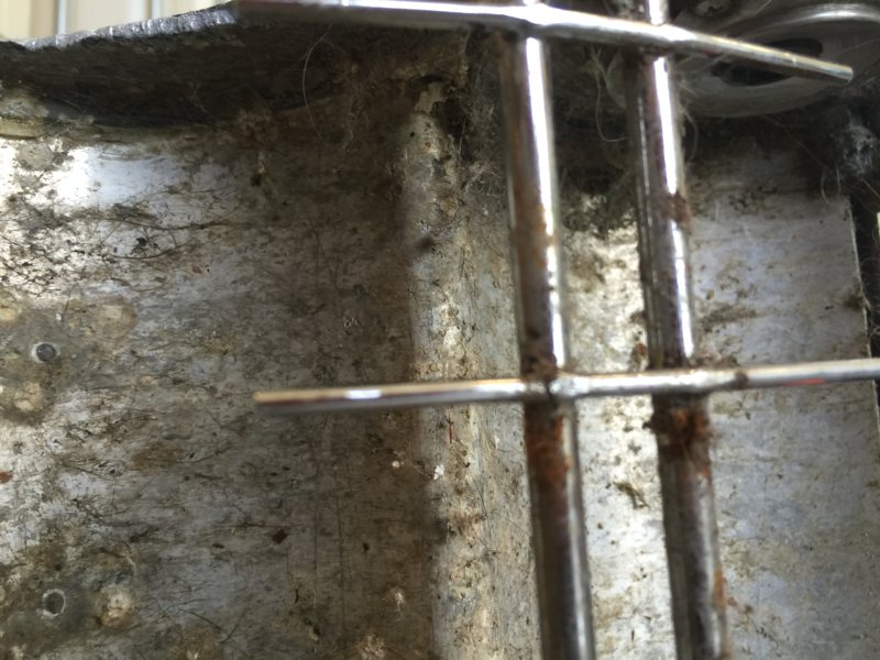

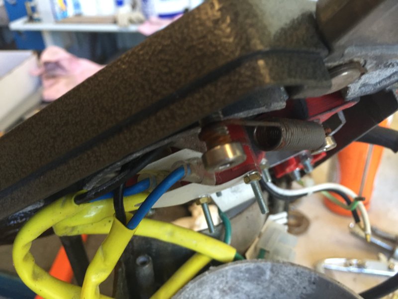

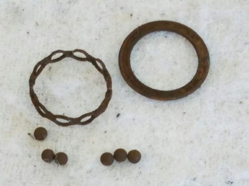

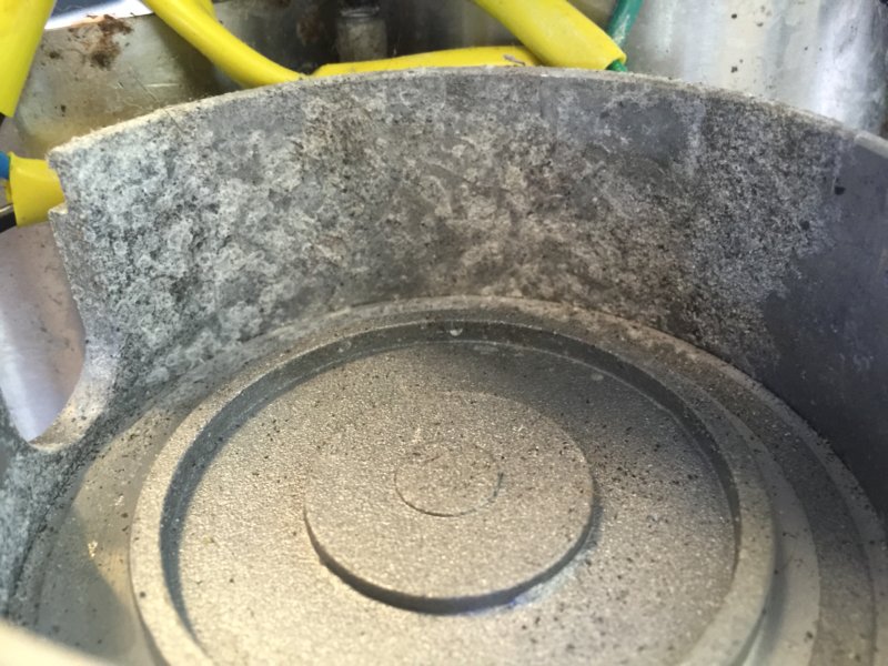

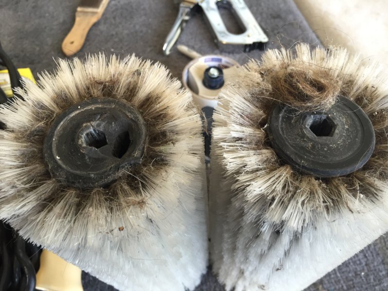

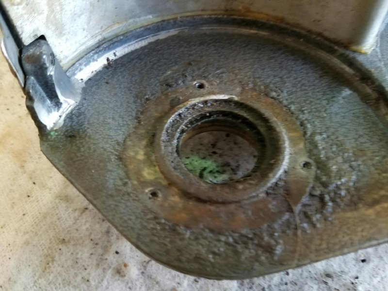

Here are a few more. Notice how in the last two pics the level of corrosion. Those areas are near the top of the machine. The spring has a lot of rust and the corrosion on the side plates indicate possible intrusion from the top of the machine.

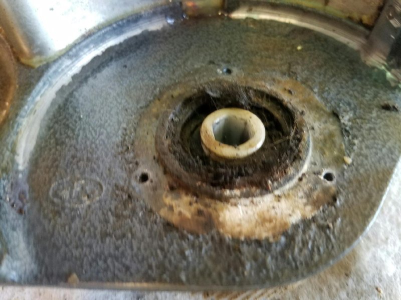

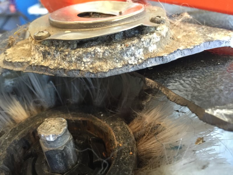

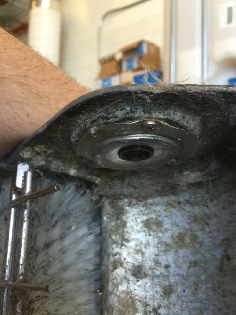

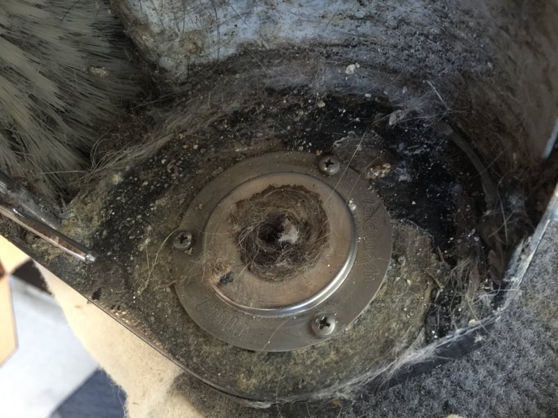

Here are pics from a machine that the user had let it go to a point of no return from a maintenance standpoint. This is not connected to the other issue. Just bad maintenance...

Yikes. Surely that bearing was making noise for quite a while. There is a way to get that outer race out of the housing, but the side plate probably should have been replaced anyway....

The way I understand it, the last batch of "crudy horror show" is not Steve's....but an example of another unit being in a rather neglected state.

You know, corrosion like that in aluminum and steel is (in my experience) caused more by leaving the metal wet for long periods more so than just having contaminants present. Steve, I wonder if your usage and/or storage habits somehow keep the moisture from evaporating after you have used/rinsed your CRB? Just a thought...
