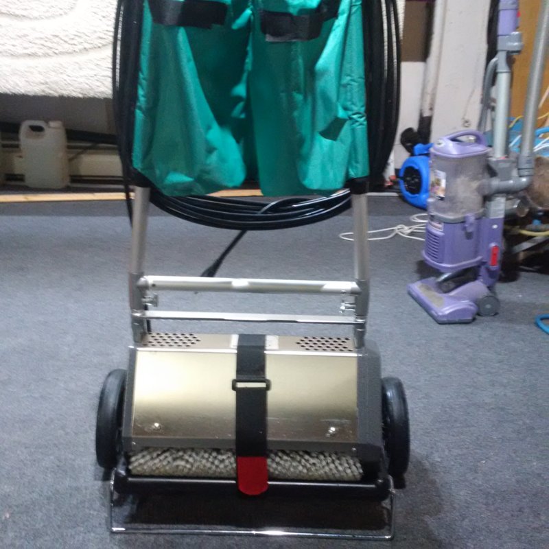

It's pretty simple really. A video would be overkill.
After each job, or at the end of the day:
1. Remove the brushes & vacuum the brushes.
2. Wipe out the housing with a mild detergent and a rag.
3. Reinstall the brushes.
~ Periodically polish the the metal cover.

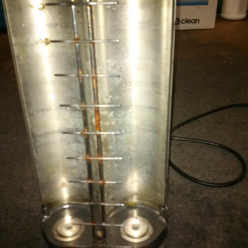

But seriously, seven pages on this thread and those of you that will ultimately decide how much a brokedick will pay for a rebuild, still haven't provided a clear procedure.
This thread discussed the idea of applying wd40...and how bad that can be.
Also mentioned the washing out...and how bad or dangerous/damaging that can be.
Then it was said to simply wipe the unit...
So what exactly is a procedure that you distributors, sellers, servicers will accept when machines are coming in? It seems like an easy way out, to tell guys: you didn't maintain it right...
Reactions: Pioneer Floorcare

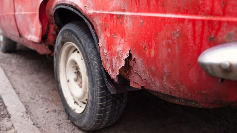

Fact is, this machine was damaged only because it was exposed to a corrosive detergent. Not because of any failure to wipe it down.
Salt is highly corrosive! Just think of all those cars exposed to road salt (before they started building cars out of plastic).
Wiping the machine down is good housekeeping.
Keeping your equipment clean (all equipment) helps it to run longer.
This is not overly complicated. Just some simple cleaning at the end of the day.
Take care of your stuff, and it will take care of you. :)

I almost did one today after our first job....
We take and roll the brushes in reverse to remove hair... Even use Vac hose to suck the brushes clean.
We seriously have in the past abused the crap out of our machines.
It wasn't until 7 years or so later we saw the effects of our abuse and not taking care of the units that I had to finally replace parts.
I seriously will never be without this little unit... EVER!
This little unit is an uzi machine gun really that packs a lot of punch for its size... And just the right size and weight that it comes off the van 5 to 10 times a day!
We have two units... One on each van... Absolutely a must have for us!

I tried to make this as simple as possible.
Fact is, salt is corrosive. Obviously, there's a need to avoid corrosives.
Most carpet detergents are not corrosive and won't harm the metal.
Vac it out. Wipe it down.
This isn't rocket science.

The problem i ran into isn't wiping the machine down and cleaning brushes. It's the hair and debris that gets wrapped around the shaft and driven into the bearing housing and bearings. This caused the bearings to dry out and get sloppy. I stopped using it before the gears stripped but the inside race contact loosened up. Probably what makes the gears strip over time.
When I bought mine I was told it's a tank and needs little maintenance. As far as I can tell it was only recently we were told we had to pull the bearing covers off to clean out the crud that gets packed in there. This should be written somewhere in maintenance instructions. And the screws strip out easily creating more issues. I have parts coming and the screws have been replaced with hex caps which is great.
I'm going to grease the crap out of the bearings and place a felt pad over that before putting the bearing caps back on. This should help keep ANY solution not just Procyon which I don't use, out of the bearings.
If this fails I'm replacing bearings with marine grade.
